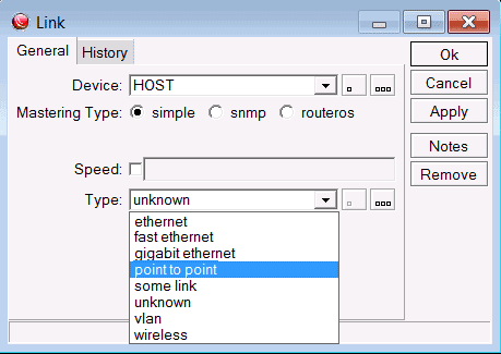

Right-click on the link and choose Settings. Then change the link type.
I guess I was looking more into changing the “Wireless” link appearance. I hadn’t thought about just changing it to point-to-point. Thanks for the information.

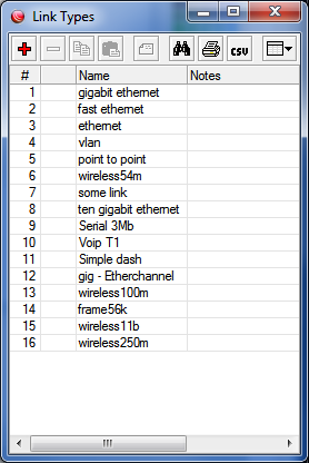

Yes you can change it to a dotted link, click on the 3 dots select the link types dialog and add your own custom link type…
