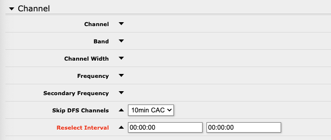

Channel reselect interval issue after upgrading to 7.15 (hAP ax²)
Since upgrading to 7.15 from 7.14 ‘wifi1’ is requiring the “Reselect Interval” under channel settings to be defined. I tried hiding the setting by clicking “^” then apply, but nothing.
From console it seems fine, but still the same result from the web interface:
I also tried to create a new wifi interface to see what would happen, same issue.
if I must define this setting to make wifi changes from the web interface, what is the right solution here?

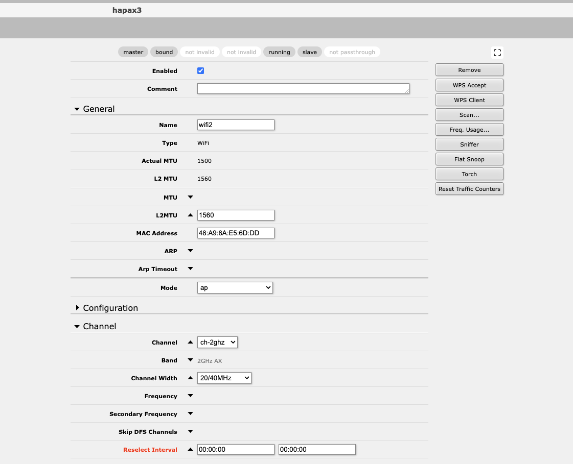

When I set “Reselect Interval” via a “Channel” common config setting and then apply this “Channel” to a wireless interface the "Reselect Interval " remains red.

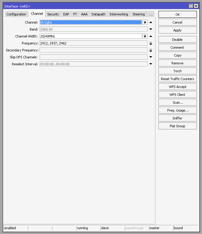

It seems to work in Winbox, just not the Web UI:
