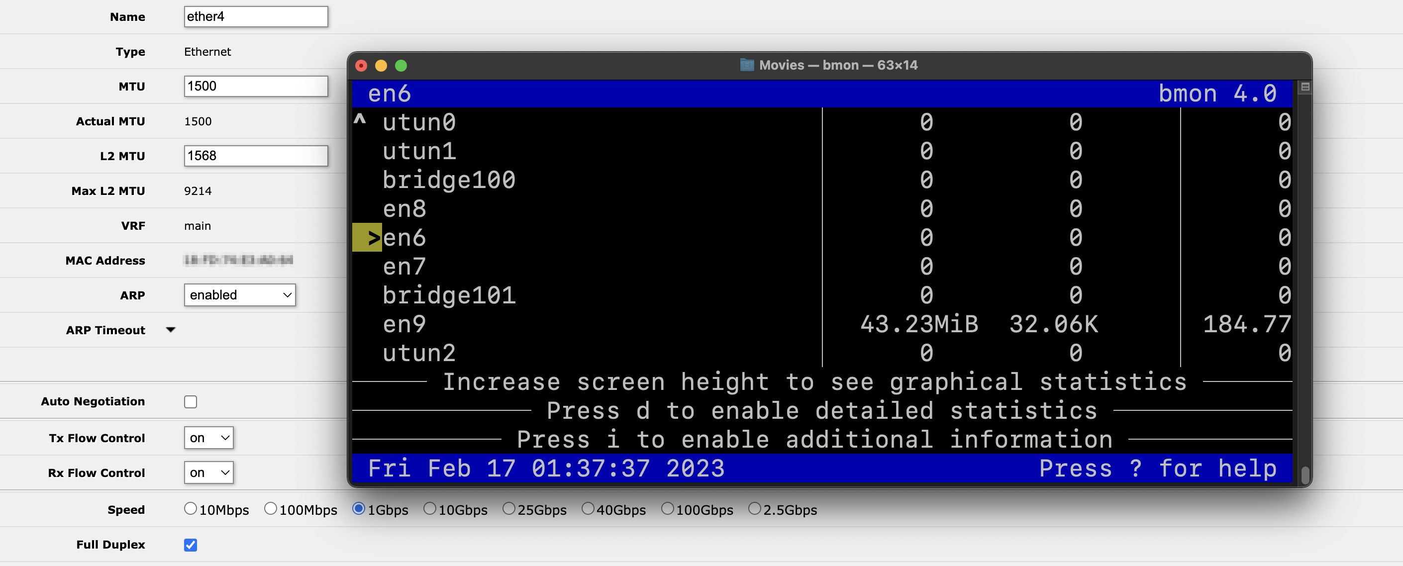

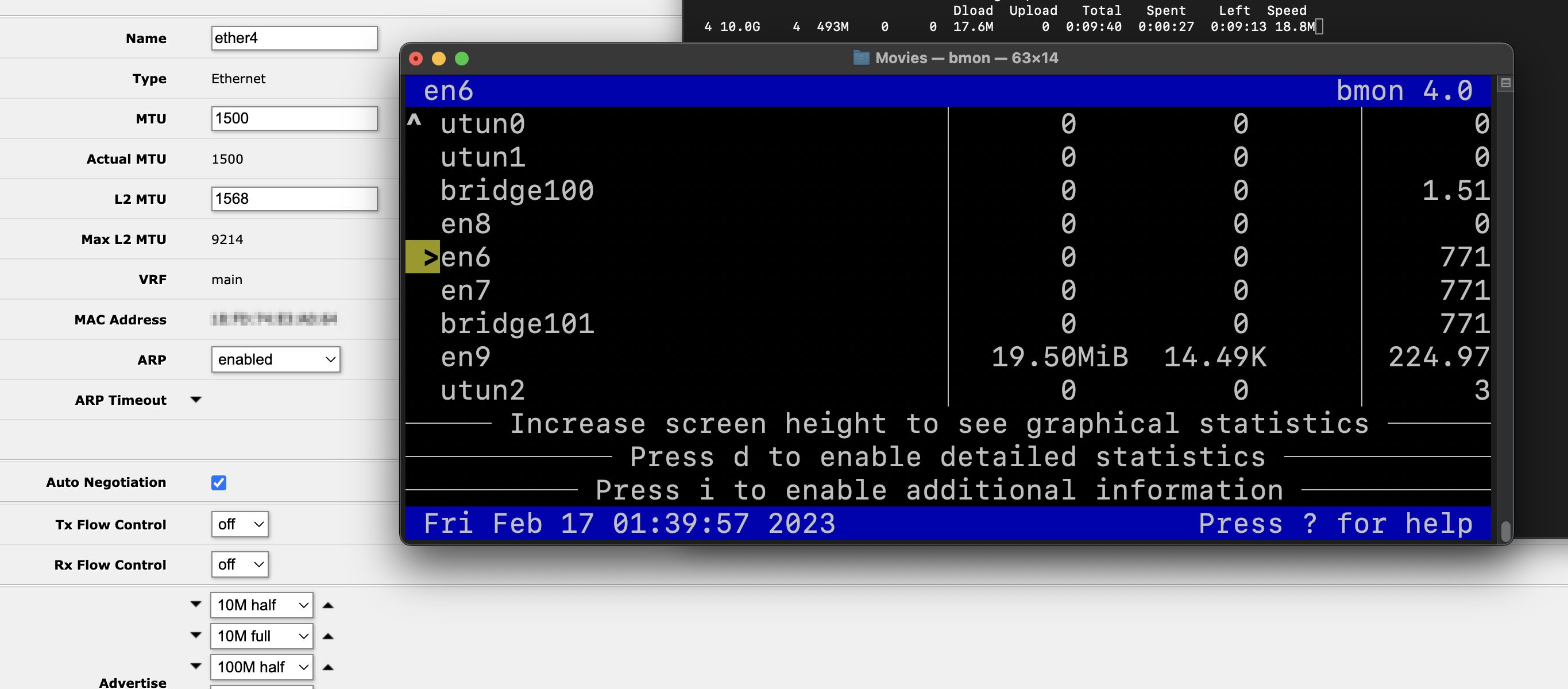

Update
While I am not sure whether this is coincidence now or in fact different in RouterOS v7.8rc2 now, but after having installed this as requested by the support and testing again, at least with the flow control enabled, it isn’t only a bit faster anymore, but rather I am finally able to achieve the same performance as via wireless LAN.
Flow control disabled (default):
Flow control enabled:

No idea on the problem. But from the screenshot looks like auto-negotiation was also disabled, and port speed was set to 1G. Might want to try that.
