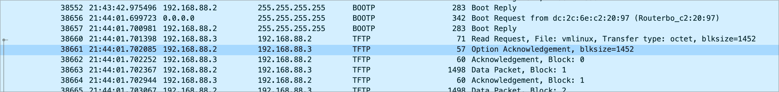

In my case I can see with wireshark:
  • bootp request from chateau 5g and reply from my machine (client ip is assigned)
  • tftp transfer for file vmlinux:

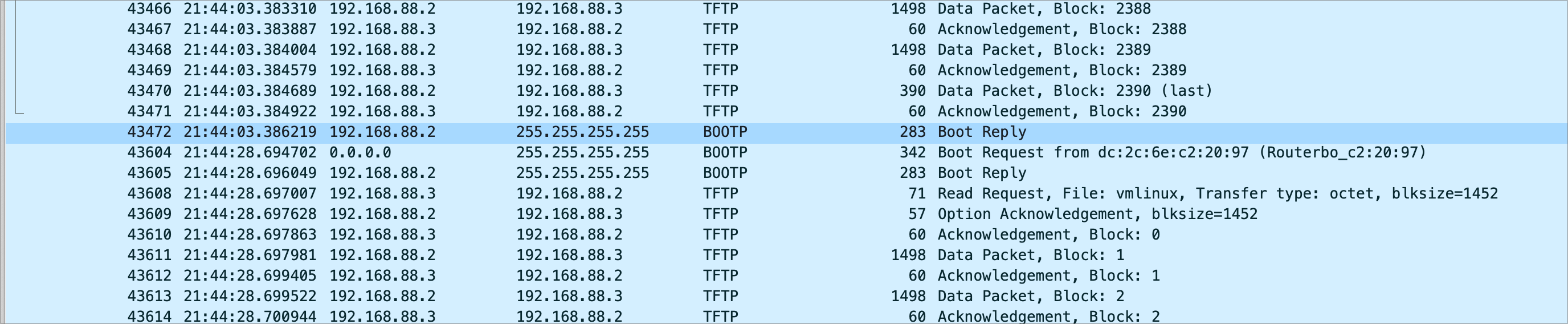

  • tftp transfer completes after block 2390 and machine seems to send bootp reply again:
During that time the power / system led is blue.
~10 seconds after the transfer (last) completes, all leds turn constant green for about a second except system/power led is purple
  • a few seconds later the process starts again
