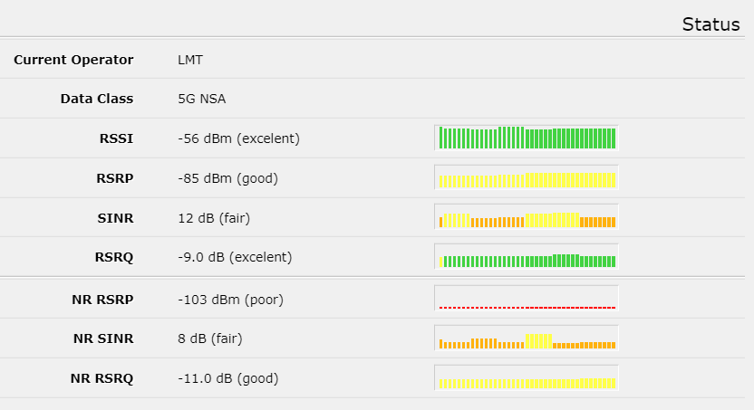

I have plugged in 5G router at my house and put it on the windowsill. The only obstacle between the router and 5G tower is a window and distance to 5G tower is 25m of open air.
Router`s signal strength shows 2-3 LEDs of 5 possible. Often falls down to 4G also with 2-3 LEDs of 5 possible.

Screenshot doesn’t show info about frequency bands used for 4G and 5G. Anyway, it seems that either tower antennae are completely overshooting your window (quite likely as there are rules about max signal strength in habitable areas) or antennae on tower are turned away from your place. In first case you could try to place Chateau higher in the building. In second case you could try to move chateau around the house (same floor) but odds to make signal better are slim.

BTW, also 4G signal is not exactly great, at that short distance it should be greater than -85dBm.

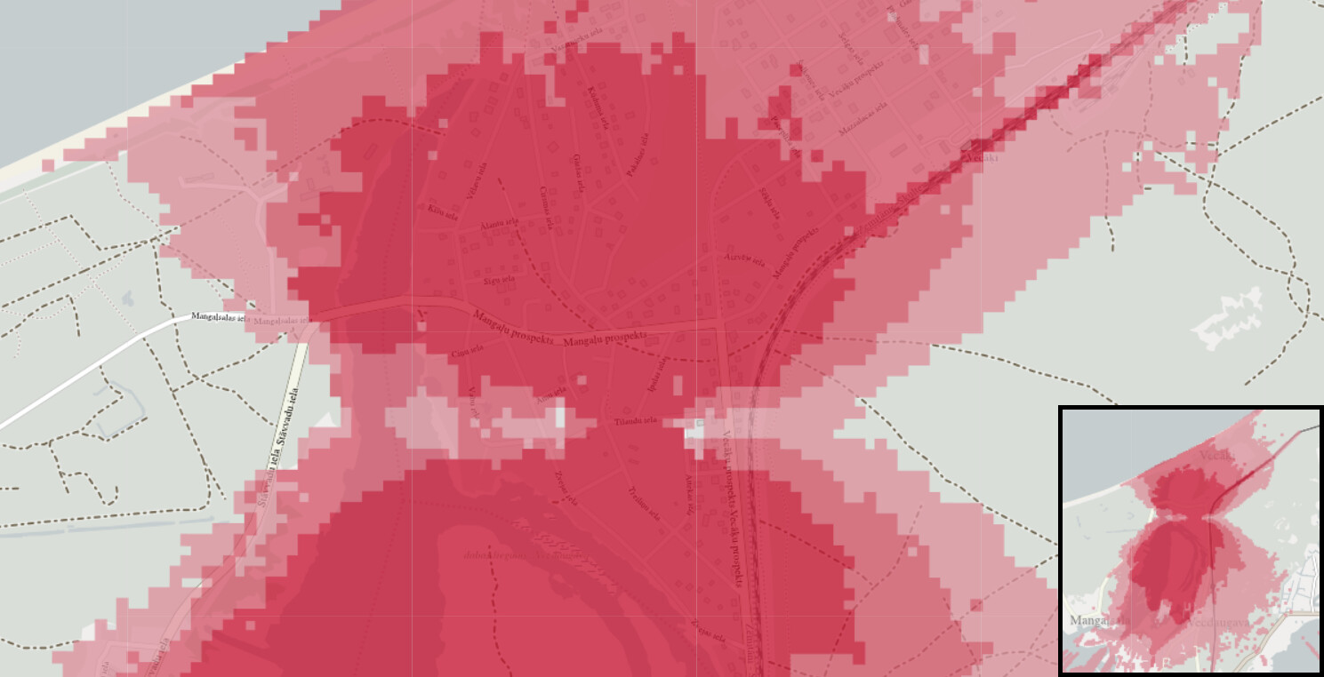

Taking a look to the map of 5G coverage of my Service Provider my house is located 25m to the east of the tower, between two parabolas but still in Excellent Coverage zone. May be external antenna can help me to increase the signal strength? BTW, comparing to my previous Huawei 4G router to Chateau 5G in 4G mode - the Huawei has better signal strength (5 of 5 LEDs) in any location of in house.

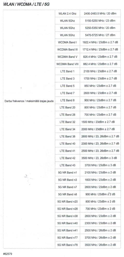

Changing LTE bands and NR bands of the LTE1 interface causes switching of router to 3G mode. So I have left them as default values.

The problem of being “between the parabolas” is that both base station cells use exactly same frequencies and interfere each other, so whatever the signal strength, the signal quality will always be less than ideal. And you can’t do anything about it, using great external antennae doesn’t help either. Some modems perform a bit better in “noisy” conditions than others, finding them is not a trivial task.
