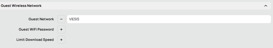

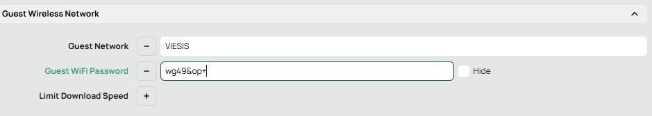

For standar wifi I can save but for guest wifi it not posible - after save password field is gray
Post screenshot please of where you try to do this.
Second image after apply configuration
That's Quickset ?
Generally it's not really recommended to be used over here ...
It has sometimes quite some quirks and problems (as you can see right now).
How familiar are you with normal configuration through Advanced ?
Button reset configuration - save the day!
