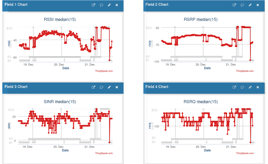

I have no troubles to connect to band 1 and 3 using any interface configuration (with default settings or enabling only specified bands), but to get stable connection on band 20 i need to specifically limit lte interface band to 20 and set network mode to lte only.
(i use cell locking to switch between them)
  • Band 3 (CA 1, 20) have good speeds (Best: ~173Mbps Down, ~60Mbps Up), but is very unstable (sinr jumps in range from 0 to 25 dBm, and rsrq is below -7.5 dB, rssi most of the time > -35 dBm).
  • Band 1 (CA 3, 20) have average speeds ( ~100 Mbps Down, ~40Mbps Up), and most of the time connection on that band is stable (sinr is quite stable - doesn’t have so frequent fluctuations like B3 and doesn’t drop below ~-12 dBm, rsrq is similar to B3, rssi is a little bit worse - > -55dBm).
  • Band 20 (No CA, as CA 1 is not stable enough - can’t recover from link down) have acceptable speeds (Best: ~65 Mbps Down, ~22Mbps Up) and have the best signal quality (sinr >= 20dBm, rsrq > -8 dB, rssi > -30 dBm).

If i limit lte interface to band 20 and enable lte network mode only, then the modem manages to get stable connection on that band.
If 3G network mode is enabled or lte interface is not limited to 20 band only, then connection drops in around 10-20 seconds after connecting and after a while tries again with the same result.
Accidentally, i’ve noticed that after getting stable connection on 20 band (lte network mode only, only band 20 enabled on interface) it’s possible to add band 1 for interface and modem will successfully use it as secondary band. However, this connection doesn’t live long and drops in around few minutes. The problem with this configuration is that modem won’t make any successful connection because of additional band 1 (check log.1_C20+C20CA1-fail.txt), i.e. right now is possible to get stable connection on band 20 only by limiting interface configuration to lte mode and band 20.

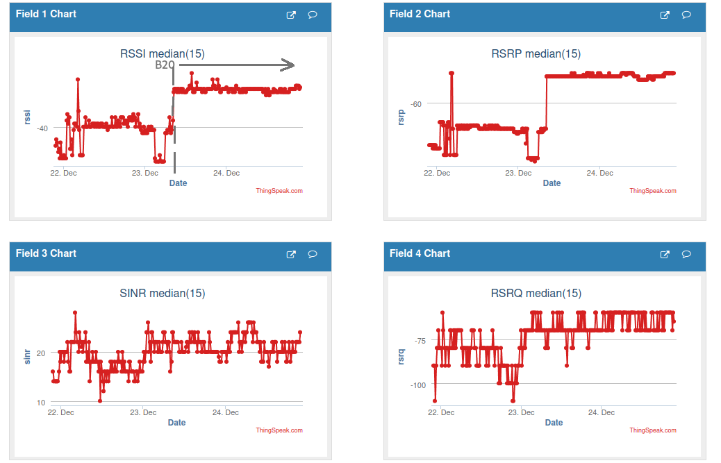

UPD 231122
The final resolution is to change the tower. Today, Bite “helped” to figure it out by powering down the closest tower, so I’ve been forced to switch to some other tower. The funniest thing is that only the farthest one worked and remained stable. The most important aspect is that it uses B20 as the primary band with CA bands 3+1. I was cautious, so initially, I enabled B20, and it remained stable for a long time. Seeing that result, after a while, I decided to check how it would behave with all bands enabled — and it’s working great.
Throughout the day, the modem was connected to B20 as the primary, and there were no glitches, unlike before. I should note that I haven’t upgraded ROS or changed any configuration, just the modem firmware. However, it didn’t help with the mentioned tower above.
