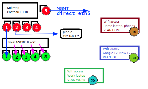

Have a question or two regarding VLAN’s, using the Chateau LTE18, extra eyeballs for feedback would be appreciated
So, to give an idea, this is the overview of the network, due to WFH, strict requirements around work laptop access and security hence usage of VLAN’s to tighten down the network
- VLAN 10 is the home network - 192.168.10.0/24
- VLAN 30 is the internet of things network - 192.168.30.0/24
- VLAN 50 is the work - 192.168.50.0/24
With the Ether5 plugged in, the bridge that has default configuration, the CIDR is 192.168.88.0/24
Without Ether5 plugged in, the CIDR is 192.168.1.0/24
- Pihole is on 192.168.1.2 and directly attached to ether2 port of the Chateau
- Other devices are attached to the switch, this is directly attached to ether1 port of the Chateau
- Firewall is as is, part of default configuration
I have read the infamous pcunite’s VLAN tutorial on this forum, and adapted to the approach here and failed to use a singular bridge that is part of default configuration
It works in isolation - different networks in their own VLAN’s, with a pihole blocking network wide - that works, DHCP works, leasing addresses and general internet access across different VLAN’s
However, because the bridges are setup individually to tie in with the address block as part of the /ip address configuration in the attached.
