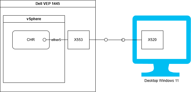

I brought a DELL vep 1445, it has intel i350 and x553 eth controllers, x553 extends 2 sfp+ ports. I intended to install esxi8.0u3 and CHR on it to serve as my home router. I have run the same configuration on a N100 box for over a year.
To simply the issue I’m facing, I can reproduce this issue in a simple setup
Passthrough the sfp+ ports of x553 to CHR(v7.14.2), connect one of the sfp+ to my desktop(x520) via Mellanox 10G DAC.
It works as expected without VLAN.

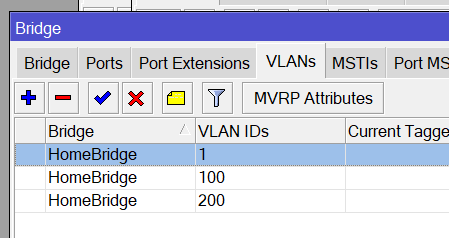

Setting VLAN tagging on this sfp+ port(ether5)

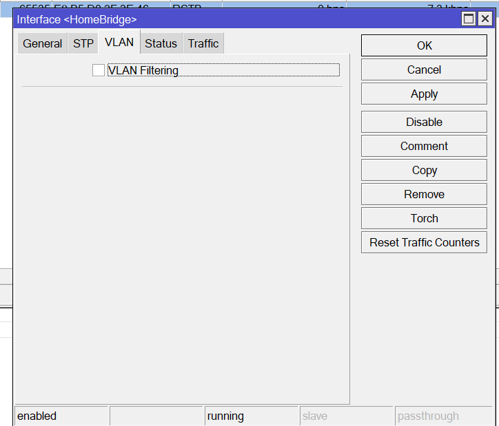

Enable VLAN filtering
Then the x520 nic on my desktop started flopping, every 20-30s

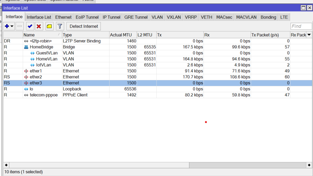

Even restarting CHR doesn’t help, and it’s even worse, the ports on x553 are gone

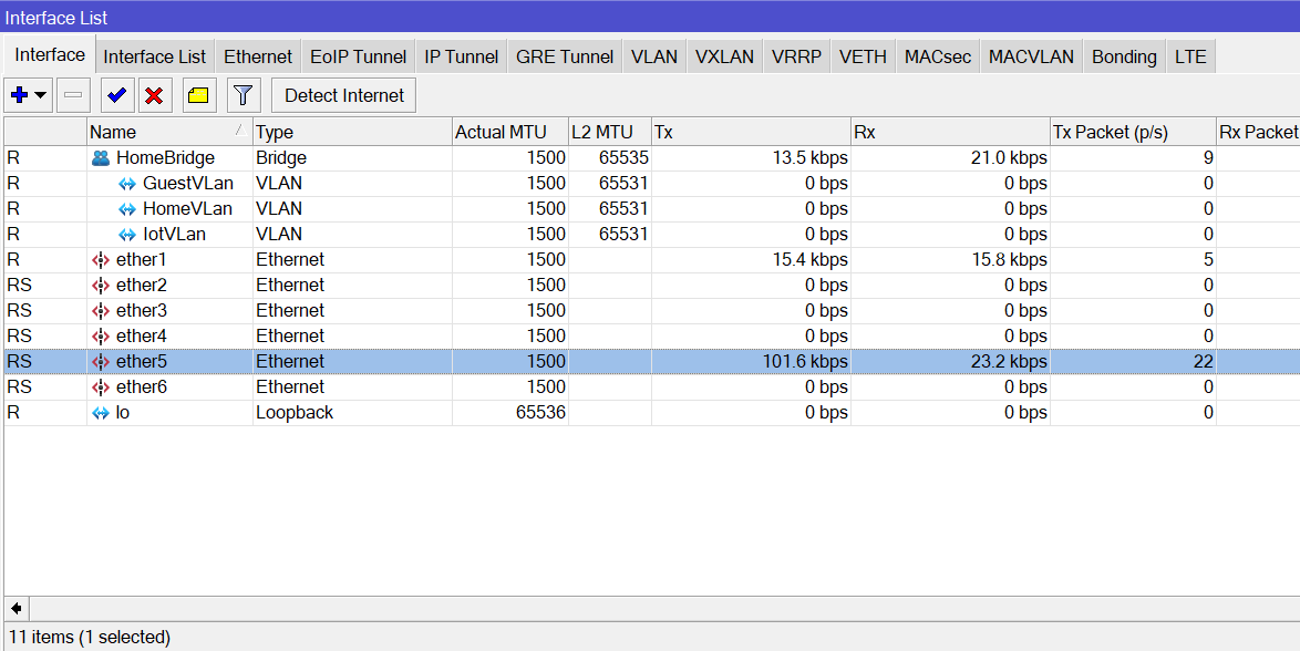

Before restarting CHR
After restarting CHR
