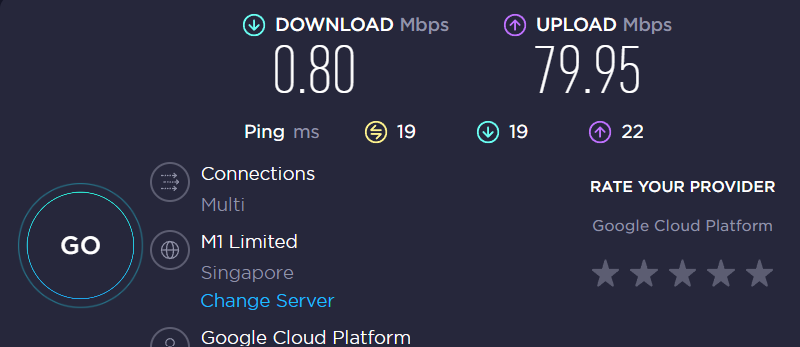

Hi, everyone,
i just host CHR on GCP, i don’t know what the problem with my CHR, my home connection is dedicated 100M Down & 100M Up, i use wireguard for VPN to my CHR and the result is below my expectation, it really take long time to load any website (30-90 seconds to open website and picture sometimes won’t load), when i open youtube, it take time to load the site, but when the video start playing the connection is normal (i test play some 4k videos and connection reach to 90mbps for stream the video), but when i try to speedtest result always show below 2M sometimes 0.3M, but no problem with upload speed.
i tried to reset factory / fresh install the CHR but the problem still there.
some said it’s because missmatch MTU, that make sense because at the first time i can’t connect to mikrotik server license (handshake error), and then mikrotik team tell me to change MSS after change mss to 1000 and it works,
does anyone here host CHR on GCP and facing the same problem like this? or i just got the bad luck?
should I move to AWS or another cloud services?
english is not my first language, but I hope you got my point
thank you
