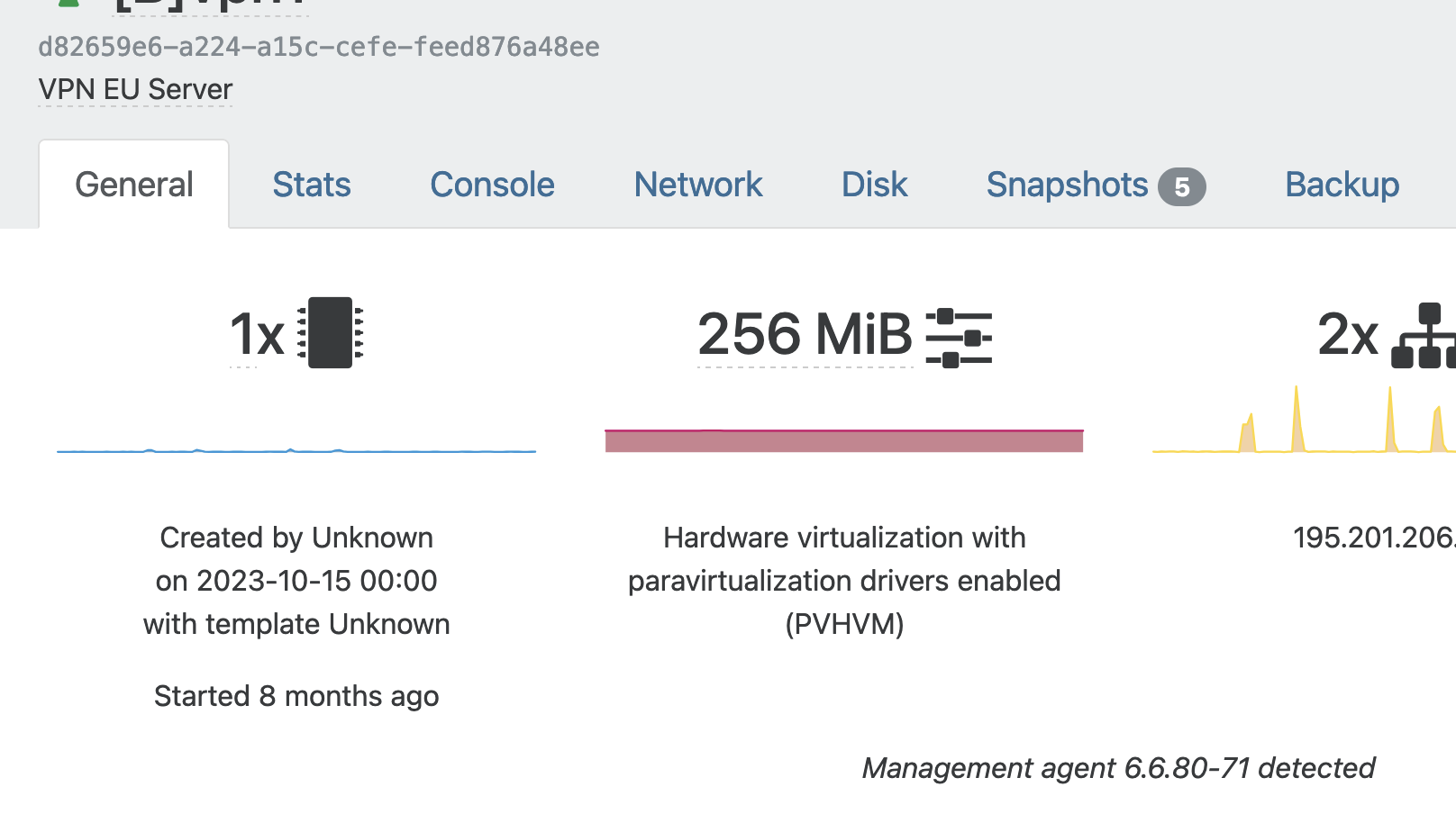

Hi there im trying to use CHR in XCP-ng

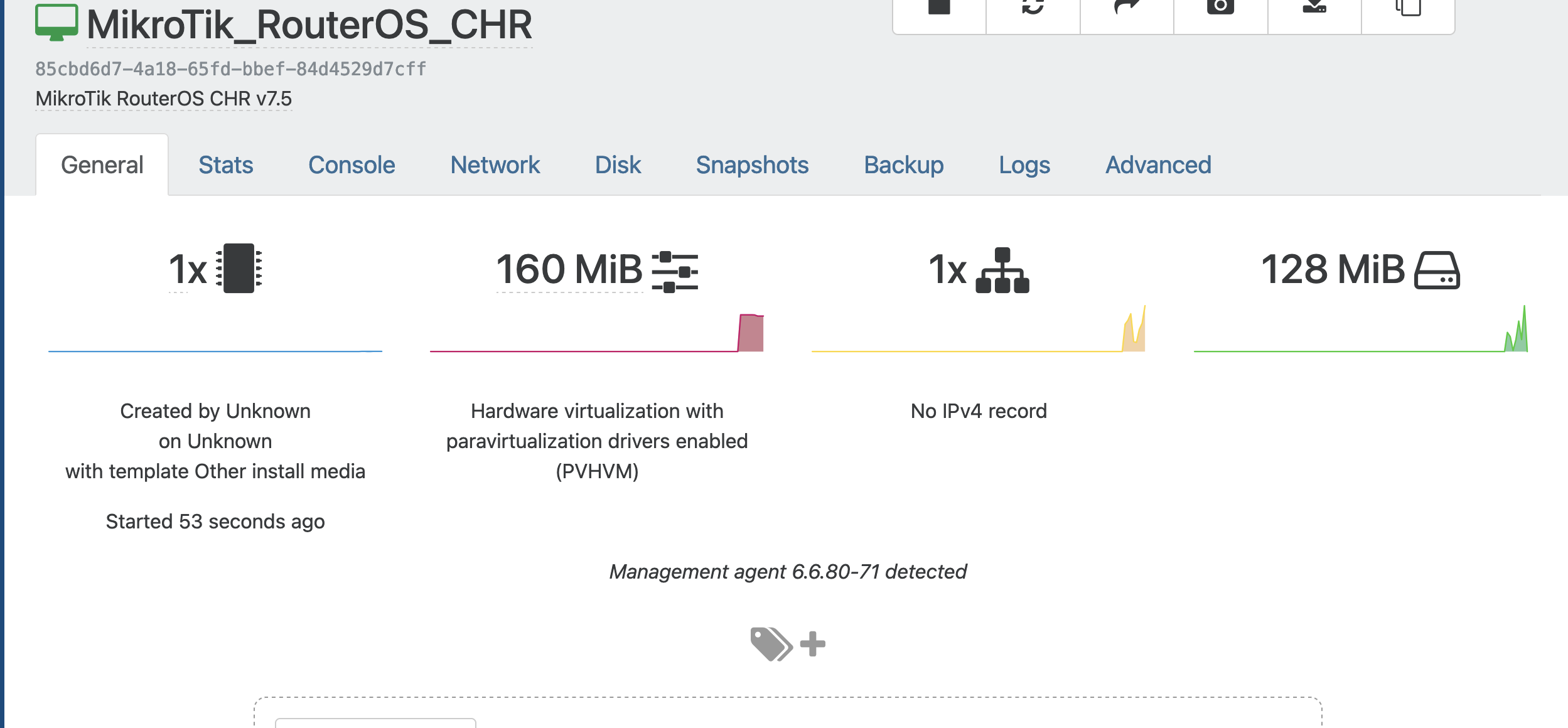

I want to use MikroTik v6 so I import the latest OVA version
but after install XCP-NG cant see Guest tool
I have found that in V 7.5 Guests agent is installed
I have one V6 CHR in XCP-ng with Guests agent

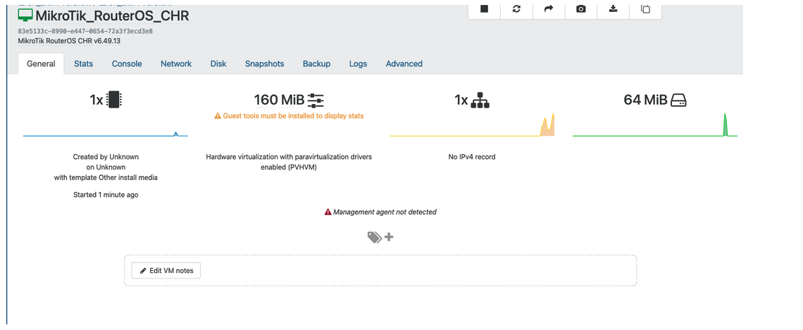

but when I’m importing OVA 6.49.1 as a new VM
it has no Guests agent for some reason
Please advice. which OVA V6 I can use which has Guest agent

I’m curious how to get XCP-NG Guest Tools on RouterOS CHR.
Ah, I see it’s included when using the OVA import. I mistakenly set up
my CHR instances using RAW disk image.
I will try migrating to the OVA template method.
