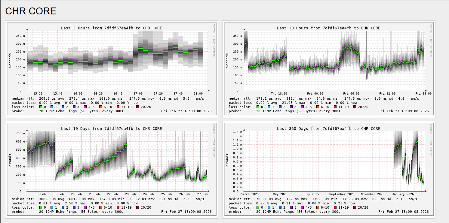

I have a SmokePing VM running to monitor latency to my CHR core gateway. From boot, the CHR shows about 100 µs latency (SmokePing → CHR, both hosted on the same Proxmox server). After a few hours, I see the latency gradually increase to 500 µs, and sometimes up to 1.2 ms.
After this gradual increase in latency, the CHR eventually appears to drop all traffic. I lose access to the router, and all traffic through it stops. The only way to recover is to reboot the CHR VM, after which everything works normally again and latency returns to ~100 µs.

where it maxes on the graph - I have to reboot CHR, thats the drops you see then it starts climbing again

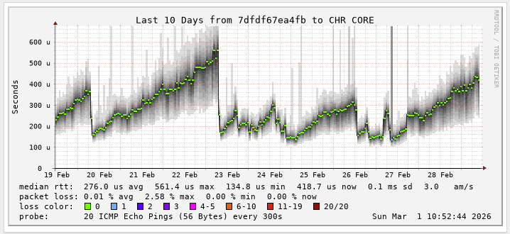

After starting a new CHR instance - the issue persists (Latency creep), but it has not dropped / failed yet.
you can see on the graph, the last climb is when I redid the CHR (27th on graph)

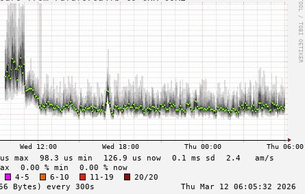

So far, so good - 7.23 is a lot more stable on CHR environment. The spike at the beginning of the graph is 7.22, and once 7.23 was installed, the graph dropped, as you can see. It spiked but then normalised again almost immediately.
Survived ± 15Hrs with no problems - Latency graph looks good.
