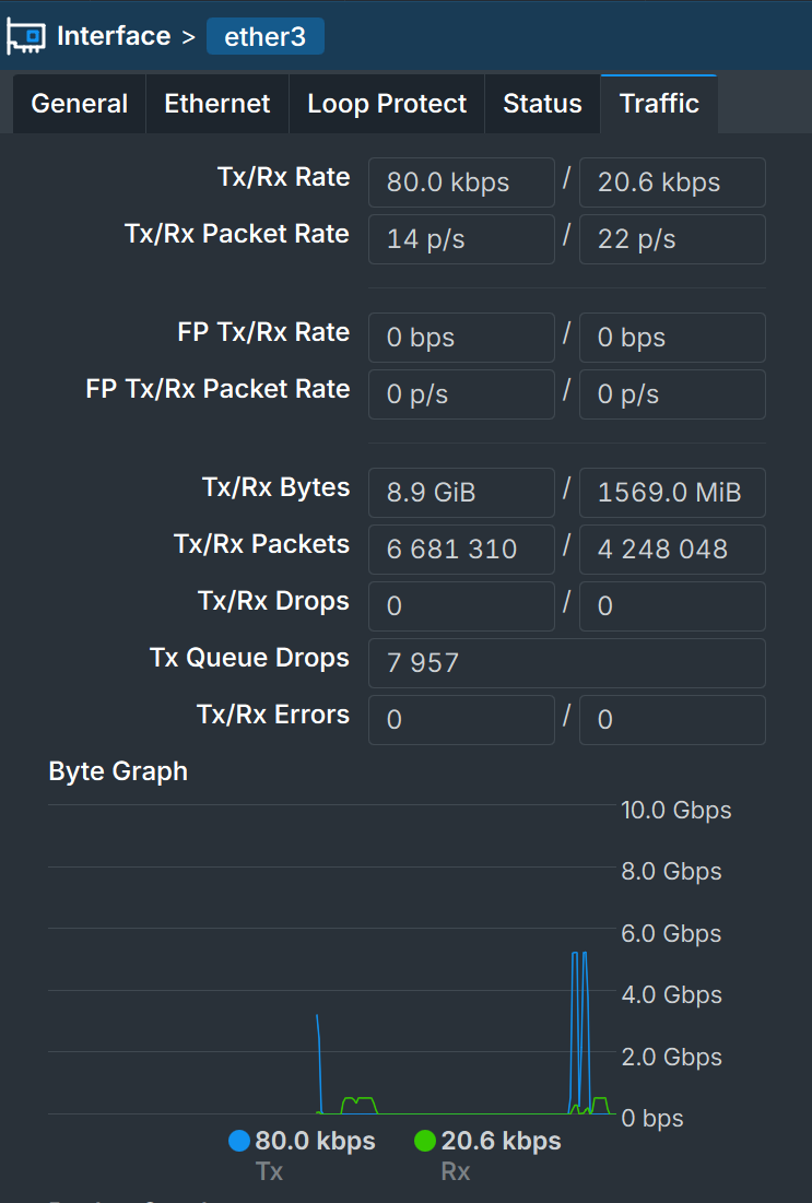

Here are two snapshots of the LAN interface:
P10 with Drops:

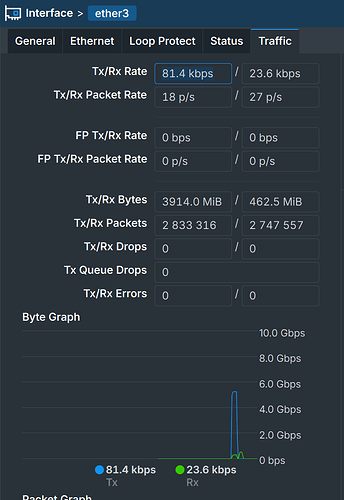

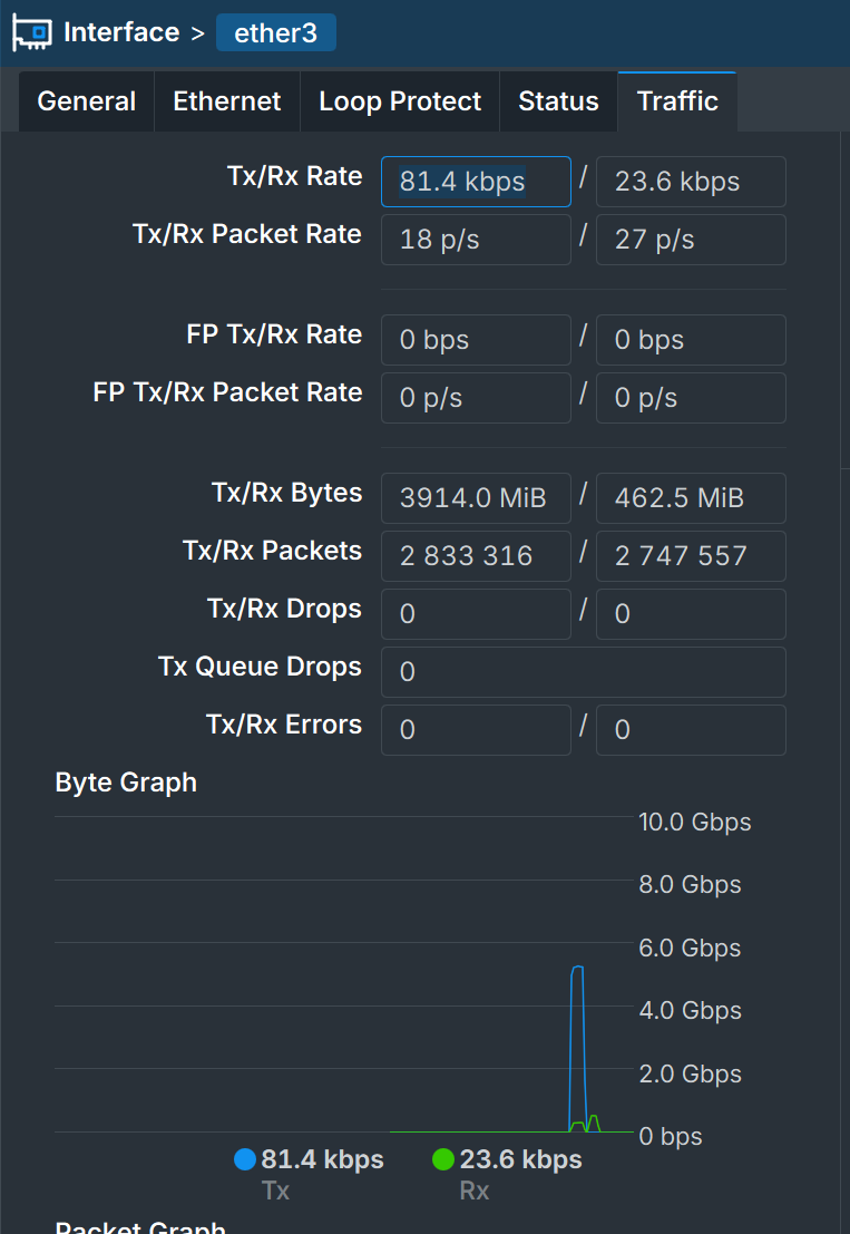

P-Unlimited per the cloning procedure above:
No drops and please note the traffic which is below 6Gbps

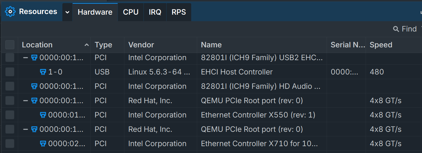

Can you show a screenshot of the System → Resources → Hardware window?
I had a problem with Proxmox and PCIE Passthrough with the Intel x553 on an Atom C3000. It was registering in CHR with only 2.5GT/S and varied on some occasions at 32x5GT/S. I swapped over to ESXi8 and CHR showed 32x5GT/s and has seem to be stable. I am not sure if it’s CHR or Proxmox or some combination of both that resulted in the PCIE speed variations.

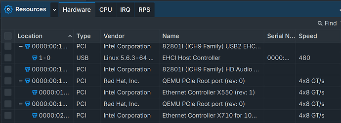

Per your request:
Resource allocation for the Intel X550 shows as 4x8 GT/s which corresponds to 4 lanes of PCIe 3.0 and 8 GT/s each which is correct. I am not sure what your numbers mean (32 x 5GT/s… 32 lanes of PCIe 2.0? )

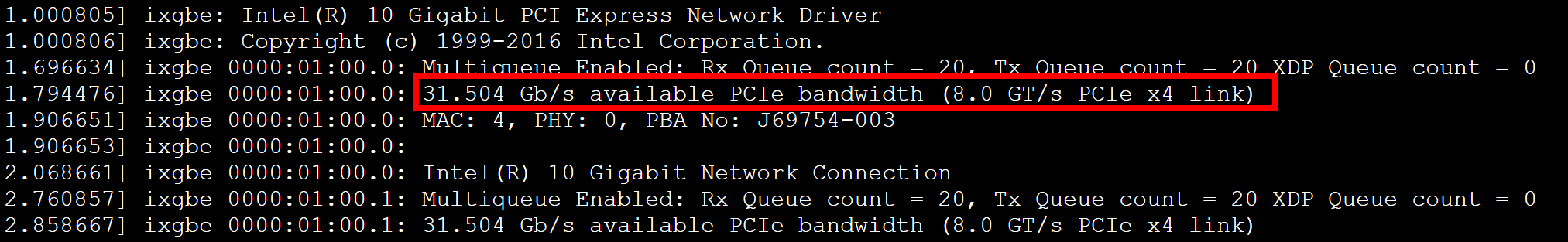

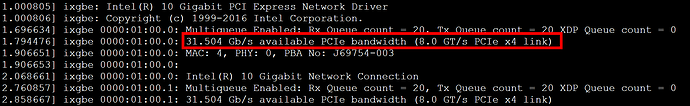

I would start with the Proxmox host to make sure that the card has enough resources to start with:
dmesg | grep ixg*
In my case this is the result: (X550)
Which is correct and consistent with the allocation within the CHR VM.
