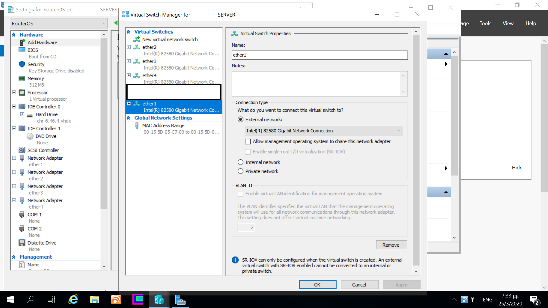

anyways im using mikrotik many years but these days i wanted to setup an CHR on windows server..i actvated CHR licence and i also purchased an intel network server card with 4 gigabit ports and i add the 4 ports as a virtual switch:
then i booted the routeros and saw the 4 ethernet ports

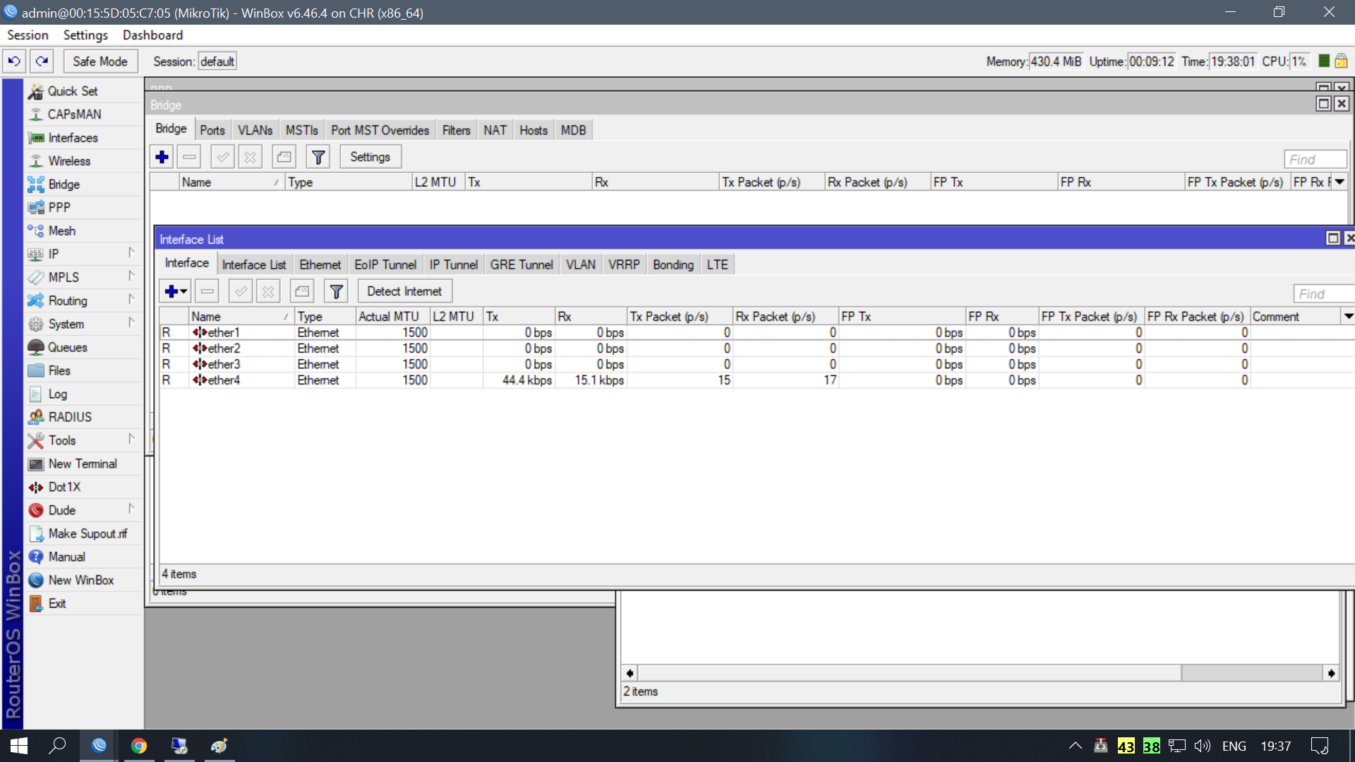

but when i create a bridge on routeros only one port at a time works (for dhcp giving ip’s etc) if i have more than one port on the bridge only the first port works, if i delete the first port on the bridge then the second works and so on…
can you please tell me what im doing wrong?

So I wonder if you have issues with Mac address protection. Check so you do not have this on for the cards.
Also in regards to VLAN etc read this one.

What do you mean? What are you using the ports for? Where are they connected to? Can you do a simple diagram a share it?
