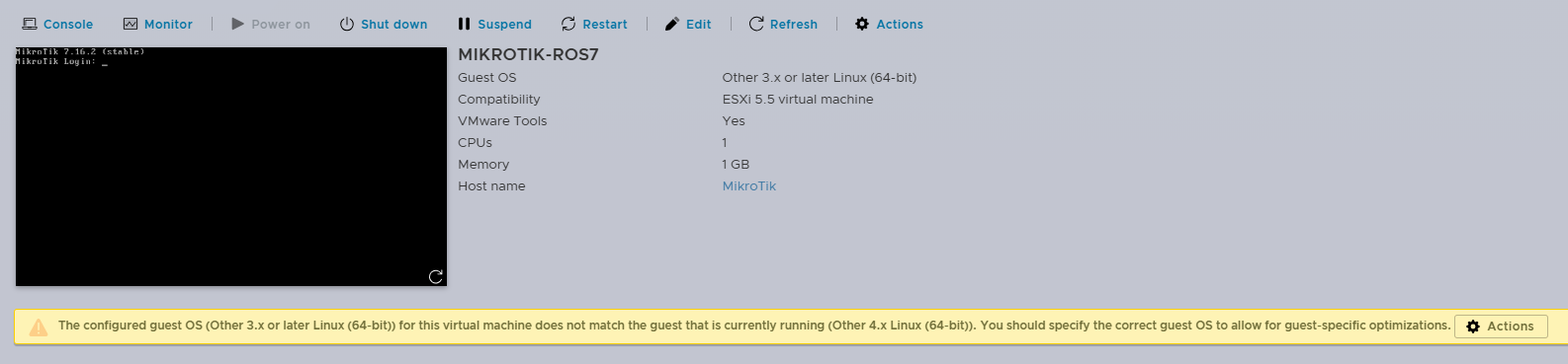

I encountered the same issue, but on ROS 7. Specifically:
The configured guest OS (Other Linux (64-bit)) for this virtual machine does not match the guest that is currently running (Other 4.x Linux (64-bit)).

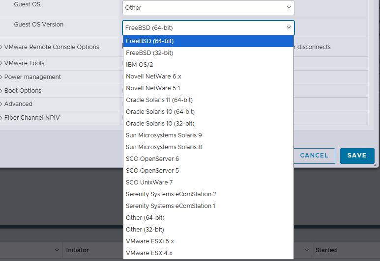

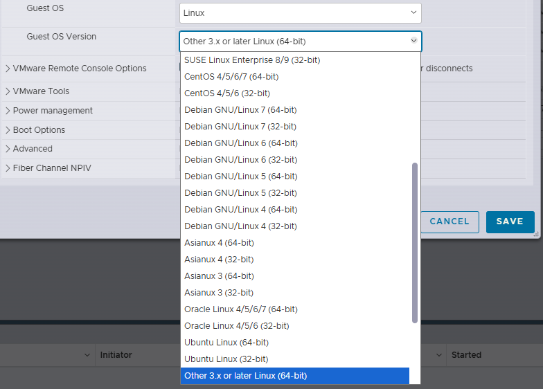

I’ve tried about a dozen guest OS options, but the error persists. Setting it to “Other 3.x or later Linux (64-bit)” doesn’t help either.
I’m using ROS 7.16.x under ESXi 8.0.3, the latest version.
You should select “Other 4.x Linux” in the guest OS option just as it tells you to do
Thank you, Cap! But there is no such option, and that is the issue.

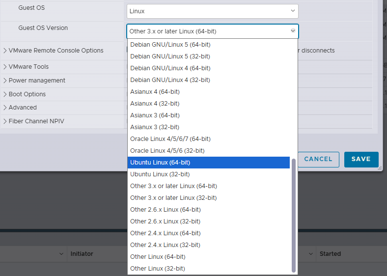

I’m no rookie, buddy. I’ve been in IT for 20 years. It looks like there are no longer generic script versions for the Linux 4 kernel in ESXi—only branded builds.
Yes, but compatibility is set to 5.5 so the available OSes for 5.5 could not cover the needed one. You have to try clone that VM, set compatibilty to the later one closer to the 8.x VMWare host and check what happens. Cloning machine will kill the license in the clone but you have to check not if cloned CHR works but what VMWare says about the OS..
You never stop learning :wink:
And today is ur day to learn about ESXi compatibility mode.
Not true. Other 6.x or later is an option in current versions (with current compatibility!)
You even have Suse 9 in the list.
current version is 15 btw.
https://www.linuxquestions.org/questions/blog/rkelsen-138375/setting-up-a-slackware64-15-0-virtual-machine-on-vmware-esxi-8-0-0-38763/
Hi. Thank you, this helped solve the problem. There’s no need to clone anything; there’s an “Upgrade VM Compatibility” option in the right-click context menu.
