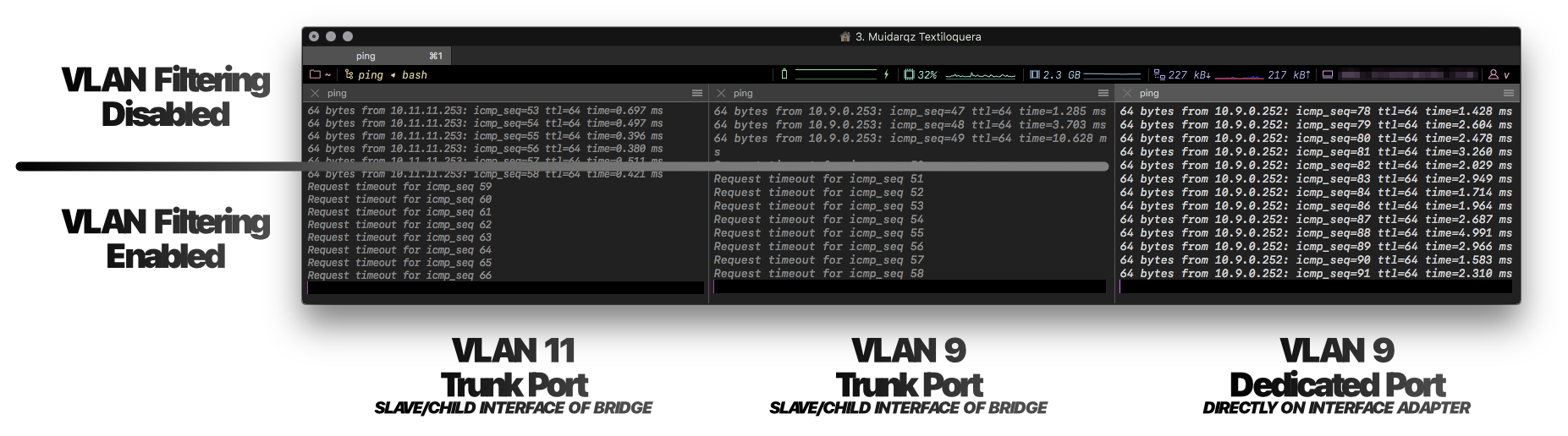

I’m trying to set up a CHR with a bridge instead of individual VLANs on an ethernet interface; all seems to go well until the moment I enable VLAN filtering, then I’m cut off.
The router has two intefaces, a trunk (VLAN 4095 — vSphere) and the second one is on a single VLAN from which I could access easily in case I’d get locked out. But, when I enable VLAN filtering even that one stops responding too, not always, I’m still trying to find out what triggers it, but it does.
Here the config can be seen at a glance:
Losing access:
That last one occasionally get taken down as well.

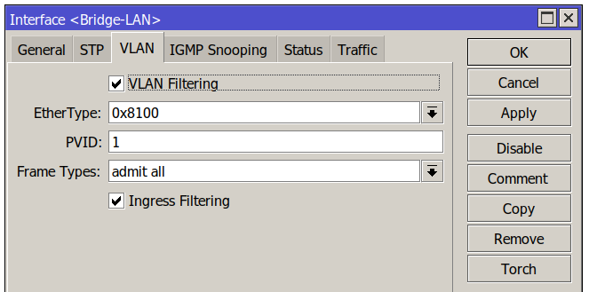

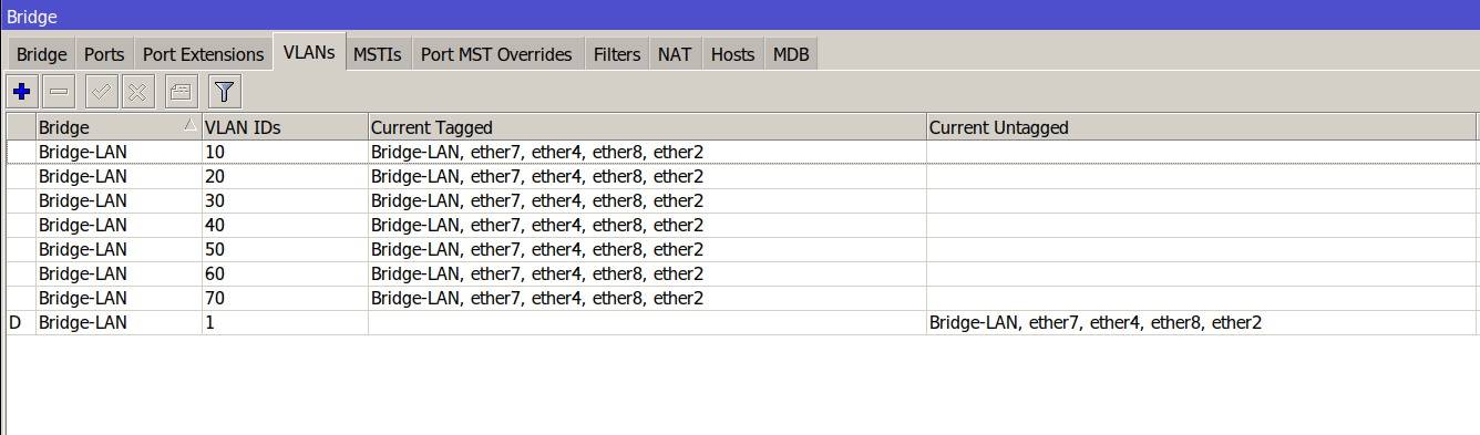

Do not forget to include your “mainbridge” on each of the tagged interfaces too.

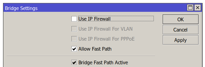

Also, looking ay my RB5009 (working) config, under the Bridge-settings I DO NOT have “use ip firewall” or any other setting with “firewall” in there.
Perhaps CHR is perhaps a completely different animal requiring different setting? No expierence with those.

There is certainly no problem using the default VLAN 1 untagged, e.g. if you have a working setup based on the intital configuration and then add some additional tagged VLANs on top. Using VLAN 1 tagged however is full of traps for the unwary, and a number of vendors hard-code VLAN 1 to be ‘untagged only’ in their equipment.
The typical issue, as the OP has done here, results in a mix of tagged and untagged on bridge-to-cpu and ether1 interfaces as the default bridge and port setting is pvid=1. This would be more obvious if the /export didn’t hide the default value.
