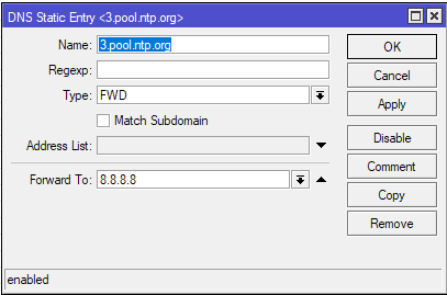

Exactly for this reason I need to have the following DNS static FWD entry on all of my routers:
The devices all have DoH with “Verify DoH Certificate” enabled, so they need to have a way to first synchronize the time without contacting the DoH servers.
