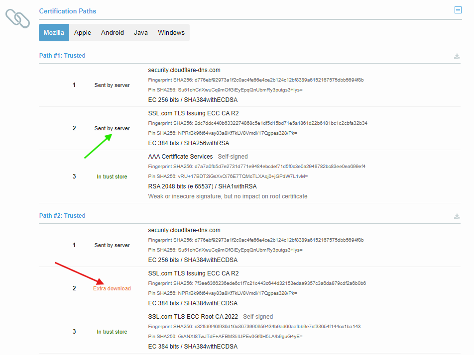

Yeah, I thought so too that this one you mention would be enough: SSL.com TLS ECC Root CA 2022
So I removed the Sectigo/Comodo AAA Certificate Services cert and replaced it with the one you linked and it does not work. It still needs the Sectigo one for some reason. So I ended up keeping both for now.
In the SSL Labs screenshot I posted above, you can see that there are two possible chains:
The webserver only sends the intermediate CA cert that is signed by AAA Certificate Services in the response. If you trust AAA Certificate Services then the chain is complete without anything else needing to be fetched remotely.
If your router does not trust AAA Certificate Services, only SSL.com TLS ECC Root CA 2022, then the certificate in between with the fingerprint 7f3ee6366236ede6... is not provided directly by the webserver. The clients must do extra work and fetch that intermediate certificate themselves. And this is something the DoH implementation in RouterOS probably fails to do.
So, in this case it would be more reliable to have AAA Certificate Services in the root CA list, because the full chain is complete, just by using what the webserver is sending.
