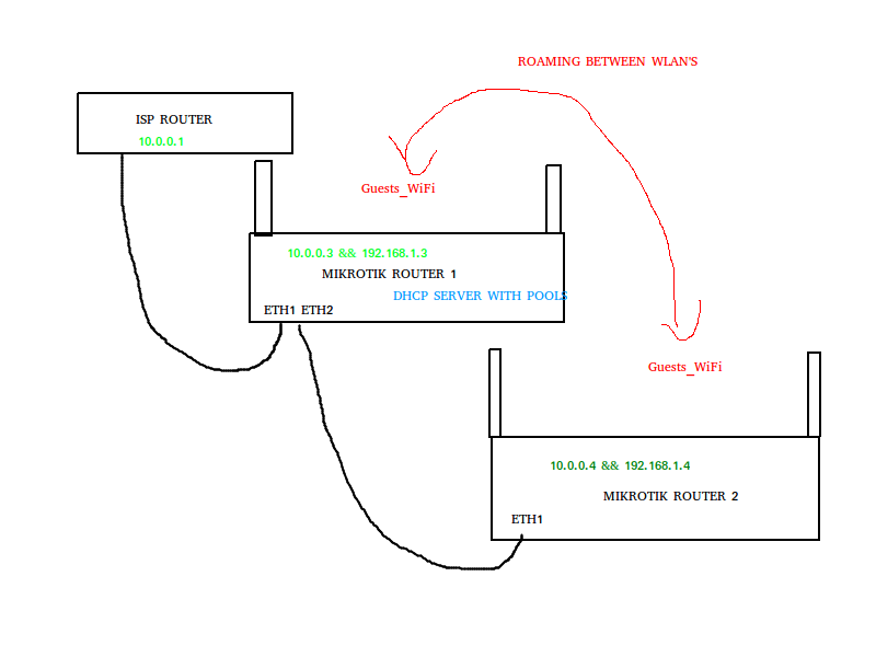

There is a little complexity added. I have two MikroTik’s at home, giving the same WiFi, so I can roam between the two. Let’s say it is called Guests_WiFi. I’ve already configured it on different frequencies and it’s working great. I would like to make it so they can see each other devices in the LAN, but not my private LAN, because I have some services that I don’t want others to know.
My private LAN is in the network of 10.0.0.0/24
I am thinking of giving 192.168.1.0/24 to guests, and try to route.
I’ve given addresses to both mikrotik, so both have 2 IP addresses. One in the private LAN range, and another in the guests’ LAN range.
I’ve also configured the pools and the dhcp-server, so one of the mikrotiks now it’s giving addresses in the range 192.168.1.0/24 and I can see other devices connected!
But I’ve got no Internet. And I don’t know why. It must be something happening in the routes.
Maybe the problem is in my ISP’s router. It is only configured as 10.0.0.1. But I don’t know if is there any way to make the mikrotik redirect the packet to the ISP’s router.
This is the schema of my network is attached to this post.

Your scheme of having three devices functioning like routers (based on your drawing) in a network is kinda, using a metaphor, having three traffic cops doing the traffic directing at the same junction. More confusion is likely to be the case as car drivers do not know which cop to listen to when approaching the junction.

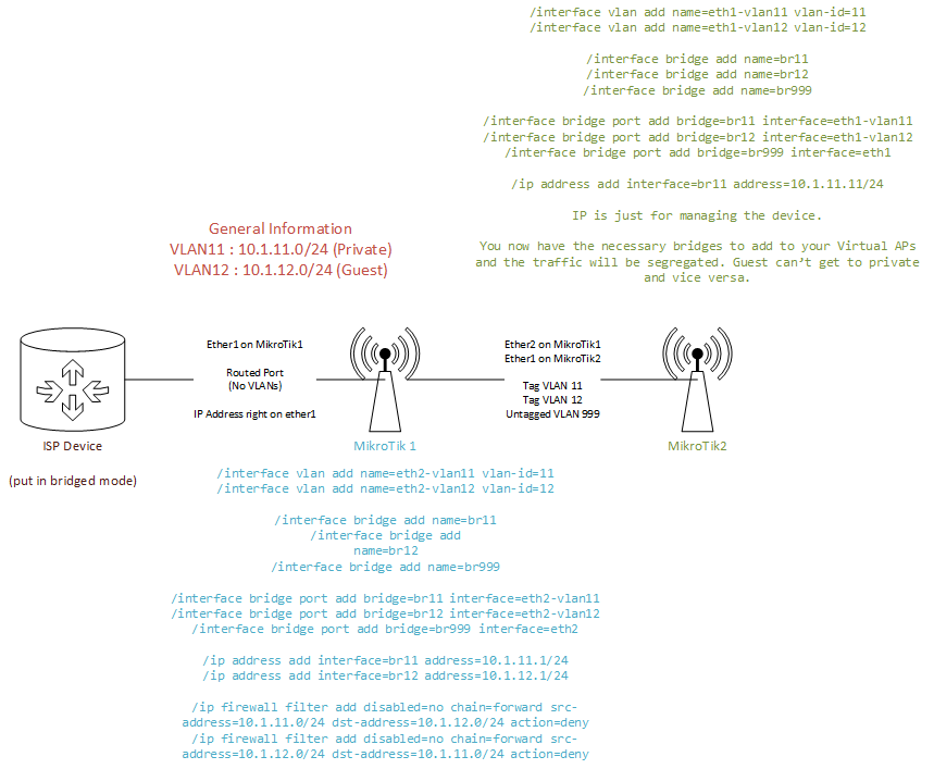

Now, once you’ve gone through that. The answer to your question has already been put in the thread. Simply have your ISP device bridge the public IP to your MikroTik. At the head-end MikroTik is where you will do all of your layer 3. You can create a VLAN for your regular network and a VLAN for your public network. You can then use Virtual AP interfaces connected to your VLAN interface or bridge on each AP to broadcast the 2 SSIDs.
Below is a Visio I tossed together on how you could do the VLAN component.
