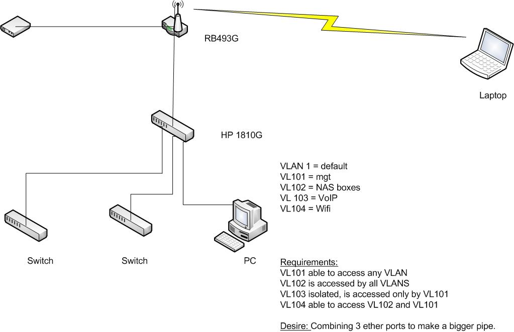

Dear Gurus,
I am confused and need some help, please.
I understand that it’s possible to increase throughput b/w RB493G and a capable switch that understands link aggregation (i.e. 802.3ad).
• Given HP 1810G being a VLAN and link-aggregation capable switch, what would be the best way to achieve this?
(I have heard a few times now that it’s better off with a VLAN capable switch rather than making a router acting as a switch via s/ware).
I have setup VLANs in the switch and also (corresponding) VLANs in RB493G. When I attempted to hook up slaves ports from the router to the 1810G, the Internet connection is lost. It’s very likely that I have missed some steps or got it setup the wrong way in RB493G.
I would really like some help and clarification from gurus in this forum.
I attach a diagram for info.

Change the interface that the VLAN interfaces are attached to from ether15 to bonding1.
I thought you might be one of those helpful people who answer my query. :smiley:
I did what you suggest. Rebooted RB493G a few times and in between rebooting my HP1810. But I can’t see any improvements in the traffic. In fact, it is a couple of MBytes lowwer than when I ran just one single cable b/w HP and routerboard.
Something does not compute in my setup as the saying goes. But I can’t figure it out.
I attached the expanded code for info in case I left something else last time.

How are you testing? In layer 2 mode all traffic between the two same MAC addresses are on the same link. You’d need to look at throughput while several machines are transferring data.
Look at the bonding wiki or the below link for some details on how traffic is distributed. Your configuration looks fine to me.
http://forum.mikrotik.com/t/per-packet-load-balancing-supported-by-isp/47934/1
Thanks fewi,
You made me think about my ‘method’ of testing over the last couple of days.
Let me get back to your question once I have done some proper tests and once I sorted out some personal issues. A week or two at least.
That way we know for sure. And perhaps others may benefit from it as well.
Although mentioned in my last post, I am unable to report on the speed of my bonding at this time. (This reply is only a courtesy).
The ASUS motherboard BIOS refused to boot up after a firmware flash that I started but somehow got hung halfway in my attempt to eliminate potential bottlenecks.
And I’m in the process of getting a motherboard replacement in order to bring the box back into life. When ready, I will report on the speed testing of my Mikrotik bonding with HP 1810G switch.
Cheers
PS. It’s contrary to what I’d expect that the BIOS chip to automatically revert back to its default and working firmware. But I guess it’s Murphy’s laws.
'And I’m in the process of getting a motherboard replacement in order to bring the box back into life. When ready, I will report on the speed testing of my Mikrotik bonding with HP 1810G switch.
I have finally managed to get a replacement motherborad and all that jazz. But I am afraid that I may disappoint you yet again.
I found out that the bottleneck was my QNAP TS-409O which can manage only transfer 22 MBytes per second at max which is where I have been testing the transfer speed.
So I was looking at the wrong spot. I need to have a rethink on testing sources and destinations.
