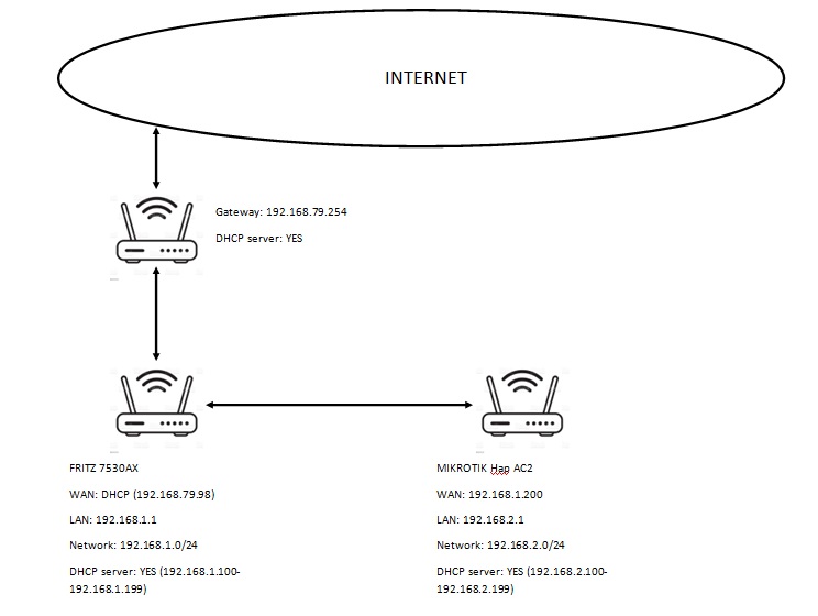

I need to communicate between two different subnets, the configuration is as per the attached diagram. At the moment if from a device connected to the Fritz network in class 1 I try to ping a device connected to the hap ac2 in class 2 I get “host unreachable”. Can I set a firewall rule on hap ac2 to make class 2 connected devices accessible?

However, I still can’t ping the devices on subnetwork 2 from 1. I don’t understand point 2 of the linked guide, how can I set the mikrotik? Am I missing a NAT rule perhaps? The mikrotik is configured with a route 0.0.0.0/0 pointing to the gateway 192.168.1.1 and with a NAT rule on the srcnat with src address 192.168.2.0 out interface ether1 with action=masquerade

From Fritz you need to make sure that you send the route for destination 192.168.2.0 using as gateway the value 192.168.1.200, the IP that you have assigned to Mikrotik on ETH1.

The other problem might be firewall on Mikrotik. Default config considers ether1 to be WAN (untrusted) and blocks everything not explicitly allowed. Also uses SRC-NAT for traffic from LAN to WAN. If you want to use MT as “internal router”, you’ll have to change quite a few settings there. Which ones depends on how exactly you want it to work …
