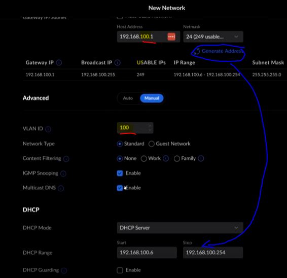

First, I guess you already know how to setup VLAN on Unifi Network Controller (Setting > Networks). As mentioned by Anav and Jaclaz, don’t use VLAN ID 1, use another number.
Example:
  • name=vlan100
  • vlan id=100
  • ip-address=192.168.100.1
  • netmask=24
(then generate address, see picture)
Repeat the process and add:
  • name=vlan200
  • vlan id=200
  • ip-address=192.168.200.1
  • netmask=24
Here I use VLAN ID 100 and 200, and also use 192.168.100.1/24 and 192.168.200.1/24 respectively so its easy to remember.
You also can use long name, i.e. vlan100-family (for family) and vlan200-server (for pc/server). This will help you in the future if you want to troubleshoot or make an adjustment.
Second, connect the sfp port from UDM to Mikrotik.
If you want to make adjustment to sfp port on Unifi side, go to Device > Port Setting. But I think leave it as default (except you know what you are doing).
If you already setup Unifi properly, feel free to ask on Mikrotik side.
