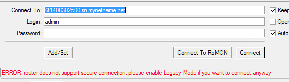

And I say that on the test above Winbox works fine with Tarpit enabled to my test router on the Wan interface.
One strange thing at your side, is that Winbox tells me that I need to switch to Lagacy Mode to be able to access your router, why?
Not seeing this anywhere on my routers.
