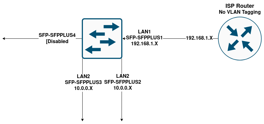

TOPOLOGY

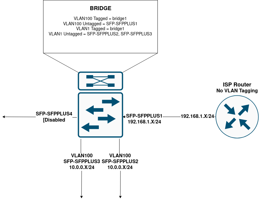

VLAN Diagram
The Idea was that VLAN100 traffic would be untagged for egress out port sfp-sfpplus1 while tagged by bridge1. VLAN1 gets automatically assigned, so I wanted it to untag VLAN1 towards sfp-sfpplus2 and sfp-sfpplus3. NOTE: Reading outloud I see that this VLAN1 untagging makes no sense. Still there is more to realize.

I’ve re-read your OP.
Long story short - lan or vlan going to different network requires routing not switching so you aren’t going to achieve what you want.
You could “just” switch your devices onto the ISP LAN and apply a Mac filter if your needs can be stretched slightly?
I think this might be basically doable, so long as the ISP router can be configured with static routes on it.
ie. 10.0.0.x/24 via 192.168.1.2 (the IP address I have assigned to the CRS)
If a device on the main ISP LAN wants to connect to a device on your new LAN, it will send the packet to the ISP router.
The ISP router will hopefully forward (some) of these packets to the new VLAN, and also send redirect icmp packet(s) saying use 192.168.1.2
to get the device to send further packets direct to the Switch.
The device on the main ISP LAN needs to accept these redirect messages. (Not sure but windows may need to trust the network)
Your filtering options for traffic between ISP main LAN and the new LAN are quite limited when using L3HW offload, e.g. no stateful firewall. (though it looks like mac address filtering might be possible)
You need to carefully review your original config, some of the pvid’s look wrong, and there may be other issues.
I guess you can set it up and get it working without L3HW offload, with virtually no enabled firewall rules, then enable the offload.
