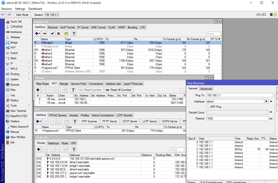

dear guys, i have a radio (UBNT) behind my mikrotik device, and long ago i had it as router, putting pppoe over it. i had no problem accessing it through my mikrotik. but since i moved the pppoe for some reason to my mikrotik, and set the radio as bridge, i can only access my radio when i connect the cable directly, but with mikrotik in the way, i have no access to it. the mikrotik it self can ping to radio…
i have eter 1 connected to radio with ip range of 192.168.1.0
and i have eter 2 as master for range of 192.168.0.0 and other port as it’s slaves.
also i have run a bridge that my pppoe is work in this interface
now i want to access 192.168.1.1 from 192.168.0.4…

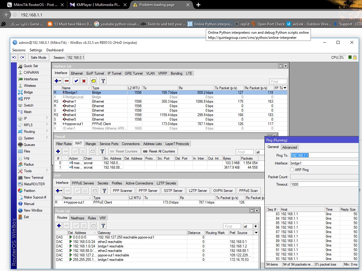

i also just now, notice that if i ping through interface eter 1, i have timeout though the 192.168.1.1 is behind eter 1. but on bridge i have ping
