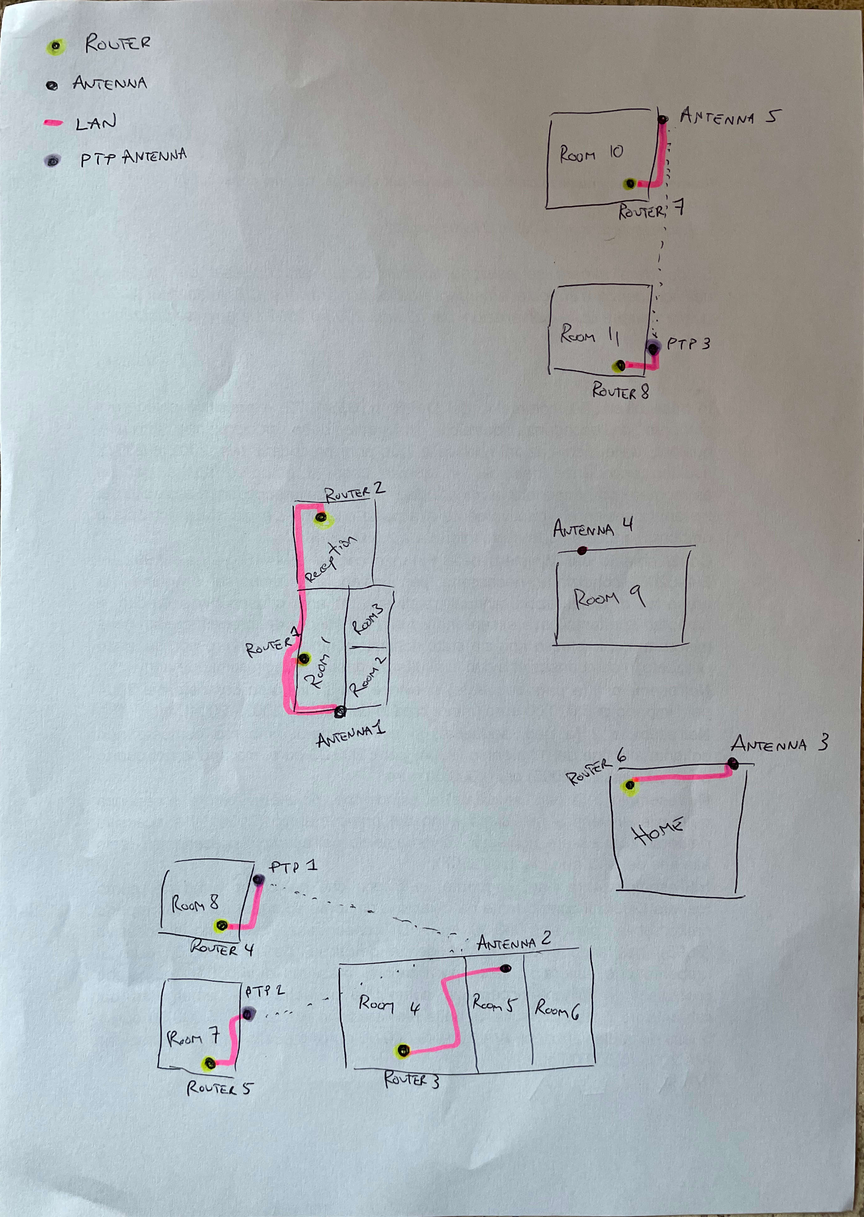

Thanks folks for the additional comments and questions. A bit more info on our property, La Piantata:
  • It is a hotel in the country side of Italy, there’s no good internet providers, or even cell reception, except for ONE provider in the area.
  • This implies that all the guests that come to visit have no reception or connectivity, so we wanted to offer connectivity
  • The 12 rooms within the property are spread out across a few hectares of very country side land.
  • Originally, I had worked with a local technician to get a LAN cable put between 3 of the different structures that are within reach, but within a year, one of those cables got damaged (mice, rain, lightening, uncertain)
  • So decided given the connectivity provided anyway (30-50MB download max), it’s not worth it. So we’ve gone for 5 antennas that cover the different structures with minimal additional connections between them (I’ll provide a diagram below with more details - each square, subdivided or not - is a separate building).
In terms of my requirements:
  • Given the 12 rooms, we have about 10 different WiFi connections.
  • Everyone else in the family / that works at the business doesn’t really understand anything more than the fact that there’s a wireless connection
  • I tend to travel for work as Technical Presales in a tech start up, but need to be able to help with any issues that might come up
  • When I say issues/tech stuff, it can be the simplest of “a customer can’t connect to the wifi”, “connected to the wifi but there’s no internet connection”… from those two, I might be able to explain to others which router to restart or if it’s an antenna that needs to be restarted or if they need to contact the installer or the provider directly… or for example i’d like to be able to regularly run speed tests to get an idea of the connectivity speeds of the 5 different antennas to understand if we can optimise the location of any of them
In terms of your explanation @holvoetn, I’m guessing this section from the config is the VPN connection to the carrier’s external server. I could try creating a Google Cloud VM in the cloud to which I could create a separate pptp-client connection that I can then use for my own purposes?
