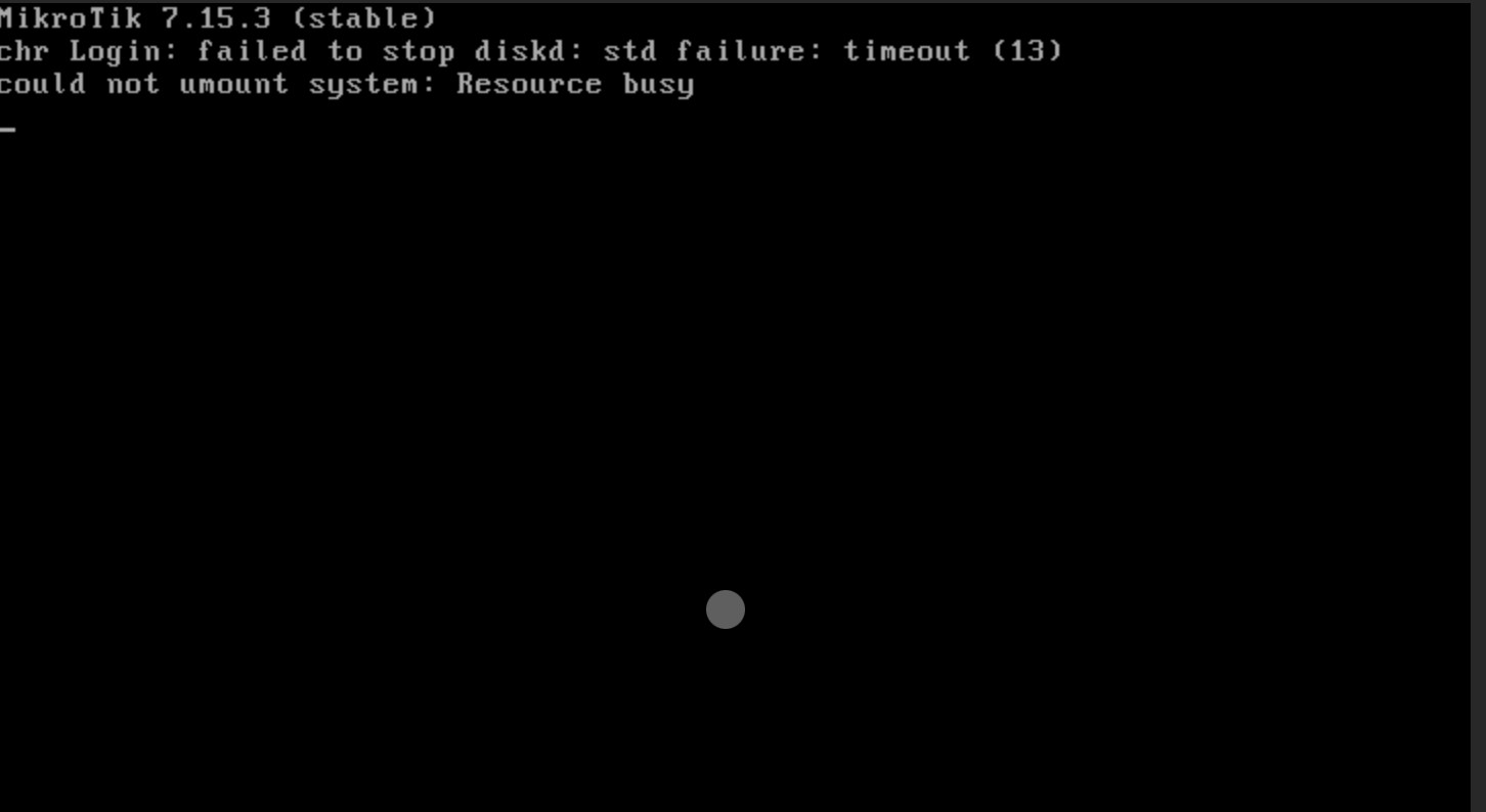

I tried running the example outlined here, between 2 Mikrotiks:
https://help.mikrotik.com/docs/display/ROS/ROSE-storage#ROSEstorage-Configurationexample
With an L009 with a USB drive as target, and a CHR as initiator. This works also leads to the initiator (the CHR) stopping to respond, and stalling during a soft reboot (see attached).
I am starting to think that the initiator side might just be generally broken, and it is not related to e.g. the Synology NAS.
