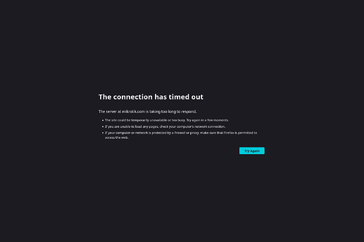

Hello everyone, I need your help to understand whether this issue is with my ISP or with Mikrotik’s websites.
When I try to access any *.mikrotik.com domain, I get a timeout during the SSL handshake.

Some points:
  • This error isn’t tied to my computer; it happens on every device.
  • Forcing the connection over IPv4 works normally.
  • Only Mikrotik domains appear to be affected.
When I try to access their sites, I just get a timeout.

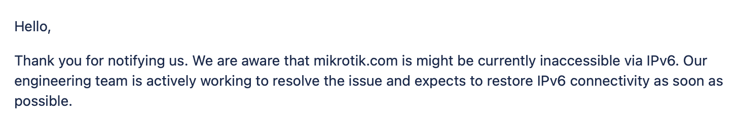

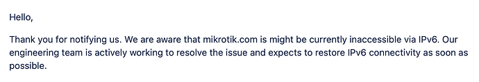

All we know is all works completely OK for some users while not for others.
This thread tries to indicate being “solved” but I posted ticket to support and linked this thread to that.
It is either an accidental fluke or problem is finally solved

* [HTTP/2] [1] [:authority: mikrotik.com]
* [HTTP/2] [1] [:path: /]
* [HTTP/2] [1] [user-agent: curl/8.7.1]
* [HTTP/2] [1] [accept: */*]
> GET / HTTP/2
> Host: mikrotik.com
> User-Agent: curl/8.7.1
> Accept: */*
That's because if you scroll up, you'll see that you've ressurected an 8-month-old thread :wink: :
And as we can see now, the current issue (some problem with IPv6 at MikroTik hosting provider / CDN) is not related to the issue of the OP (which was MTU issue), that the "solved" mark was set for.
Of course I understand that - but this is essentially the same problem. It looks like they finally caught on…
