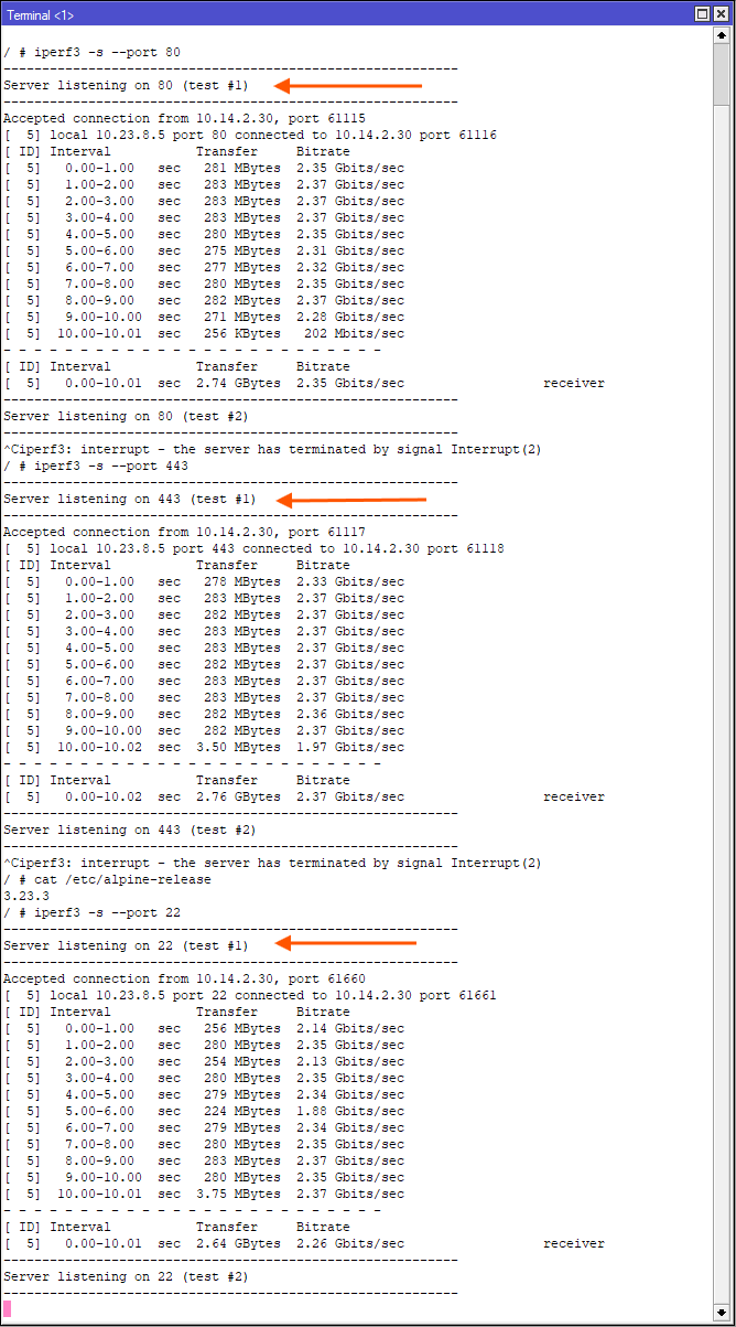

This assumption is obviously wrong, because the containers have their own VETH interfaces, with their own IPv4 and IPv6 address assigned. The interfaces are not the one RouterOS uses for its services. The behavior you observed is solely a restriction of the softwares that you run inside your container or their configuration.
Case in point: I just fired up an Alpine (library/alpine:latest) container, added the iperf3 package with apk. And iperf3 running in server mode has no problem listening on all the ports you have in your screenshot, and can of course accept incoming connections:
