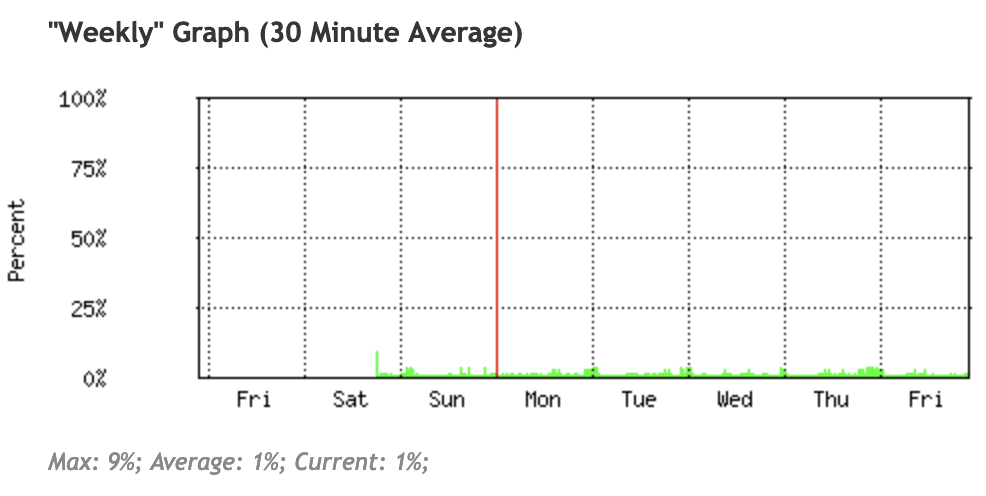

Dont necessarily agree. If the load is not signifcant to the router, doesnt slow other traffic down, why not.
Why should DNS be any slower one way or the other////
Depends on device, I have Pi-Hole and Unbound in different containers (Pi-Hole uses Unbound recursive as upstream DNS), 40 Firewall rules, 124 mangle rules, 39 queue tree rules, working every day from home, at evening mostly streaming torrents, etc…:

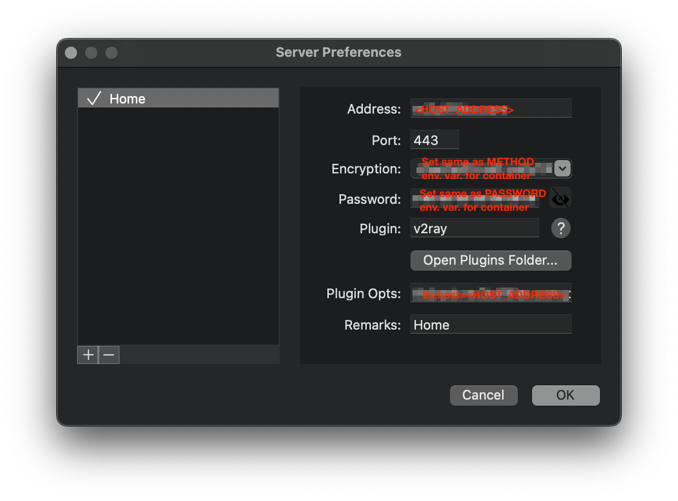

Could you share the configuration for deploying the go-shadowsocks2 client mode container?
ShadowsocksX-NG (Mac) Server Preferences:
I meant something else. Is it possible to run this container in client mode on Mikrotik. My server is set to ubuntu
I think yes, at least for non transparent proxy, but I never tried so I don’t have something to share. Ofc, for non transparent setup you will need manually to add proxy address (container’s IP/hostname) and proxy port in client OS/browser.
