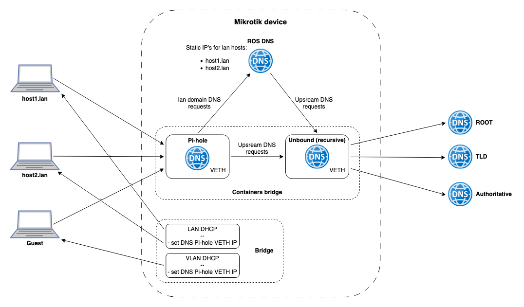

I’m using Pi-hole and Unbound as recursive resolver for some time in containers. So far so good, still, local recursive resolver has side effect - slower dns responses when host is not in cache, depends on quality of internet connection and MT device performance.
