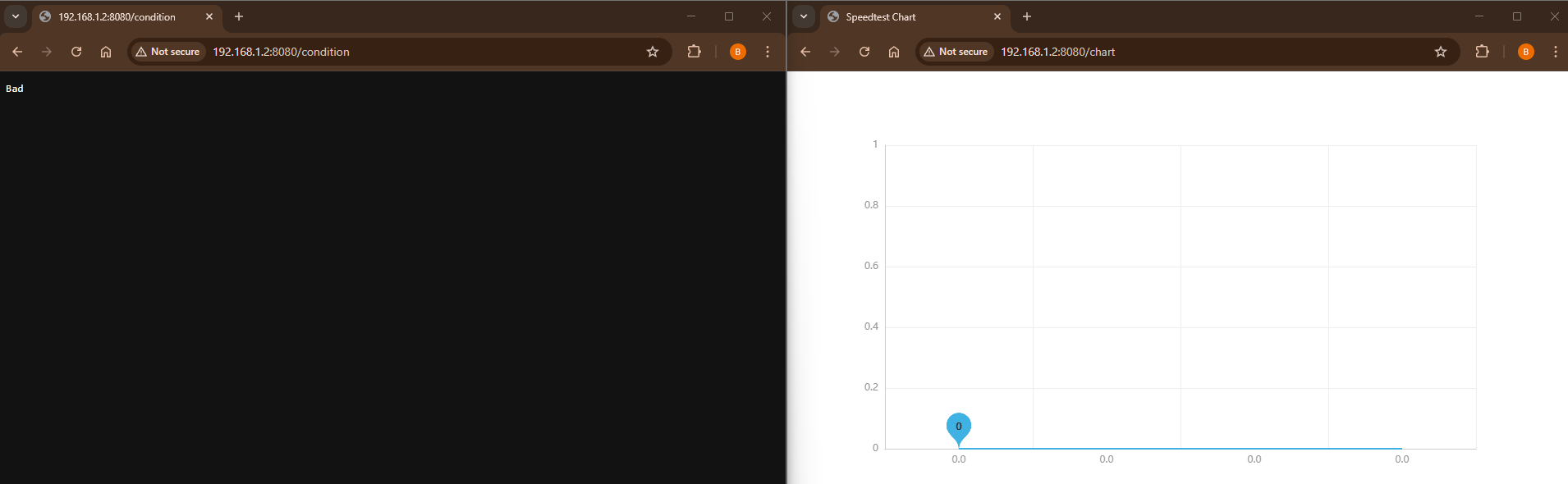

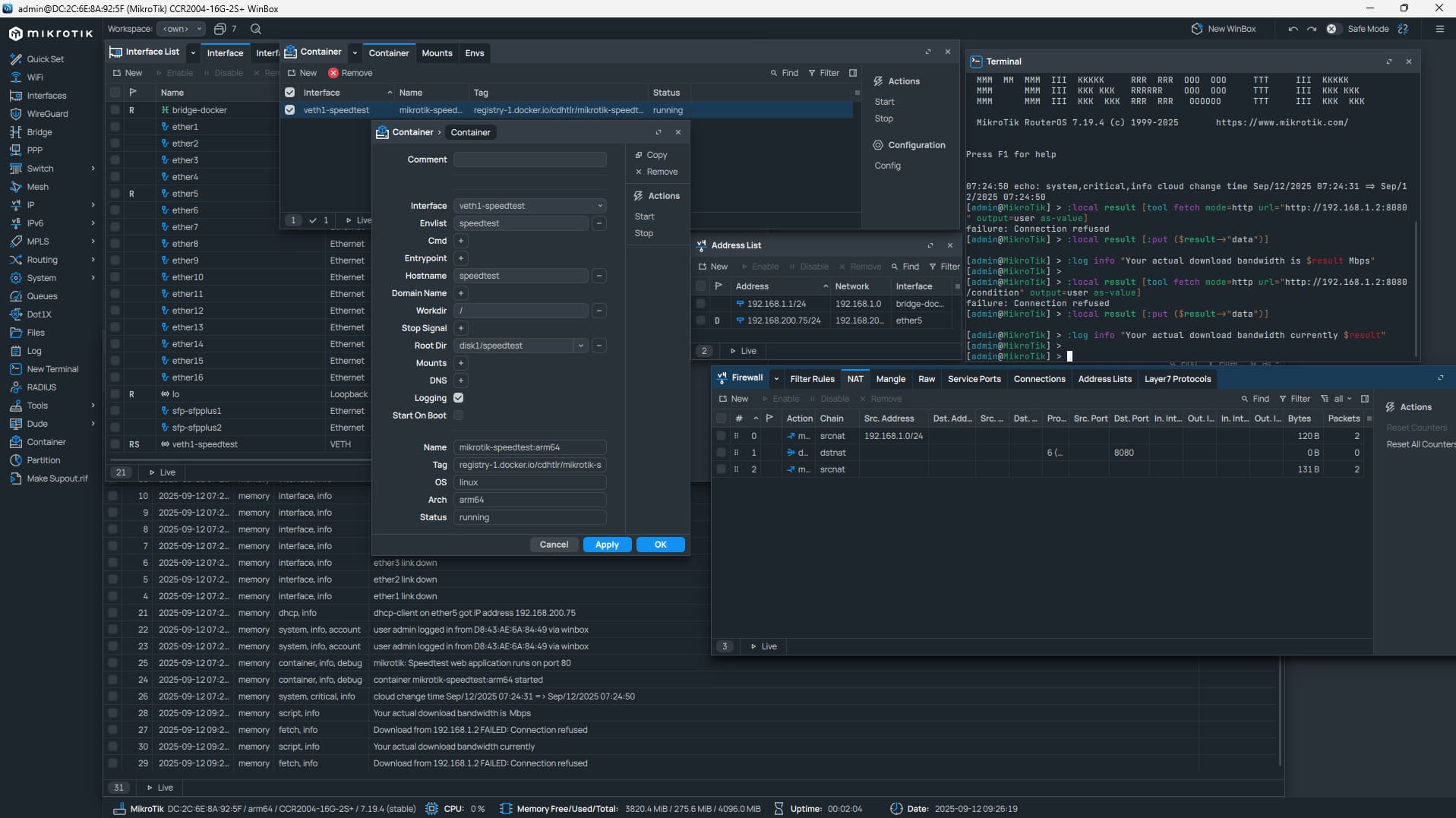

Hope this helps. I took the commands directly from the github page via the link above and made sure to use the arm64 version.

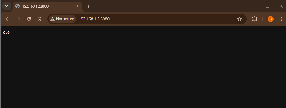

none of the 192.168.1.2:8080 urls work either.
It says it's running, did you open http://192.168.1.2:8080/ in your PC web browser?
The container is running and RouterOS is doing it's job, but it looks like the developer of this container image has abandoned it and it does not work for other people either, see in the "Issues" section, there are other that say it's always "0.0" like yours: Fails on RB5009 with RoS 7.10.1 · Issue #1 · cdhtlr/MikroTik-Speedtest · GitHub
You can try other containers like "SpeedKetchup". Those will not have step by step instructions for MikroTik specifically though.

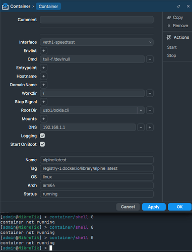

Check if the container has a DNS resolver. From you screenshot, DNS is empty. Login to the container, with
/container print
/container shell 0
0 in this case is the index of the container as displayed by print, replace with the appropriate number. Then check
cat /etc/resolve.conf
To see whether the file has a line with nameserver xxx.xxx.xxx.xxx. If not try to set the DNS on the container setting and restart the container. Alternatively, edit /etc/resolve.conf in the container shell and add nameserver 8.8.8.8 or something similar.

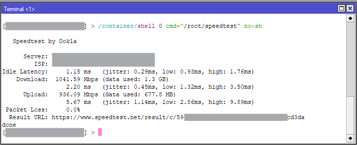

Otherwise, you can install Alpine (its only 3.5MB) alpine Tags | Docker Hub, then get into its shell and fetch the client from Ookla https://install.speedtest.net/app/cli/ookla-speedtest-1.2.0-linux-aarch64.tgz (with wget) extract (with tar -xzf) and run the command there.
If you install 7.20rc2 you can run the command from outside in RouterOS too (with the cmd parameter of the /container/shell command):

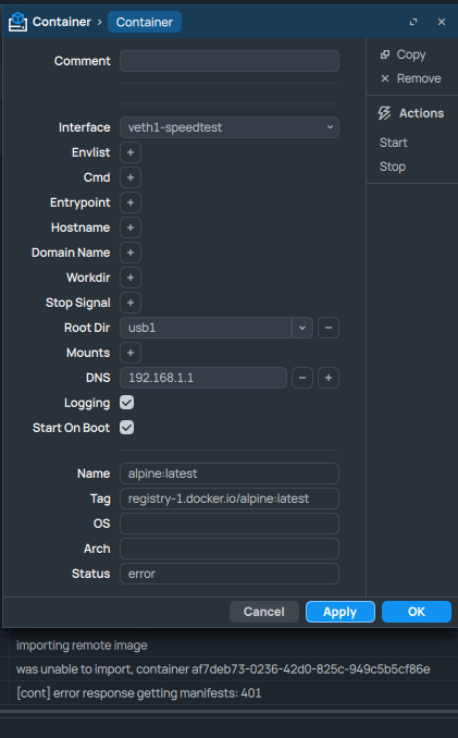

Apline wont pull
For official images you need to prepend library/ to the image (library/alpine:latest). Also don't forget to put something like
tail -f /dev/null
in the Cmd filed so that it doesn't stop immediately.

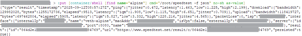

Also, in case you want to programmatically do something with the result, you can run the speedtest program with -f json and it returns the result in JSON, that RouterOS can parse into array (with deserialize):

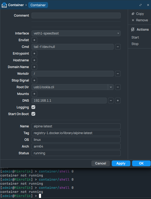

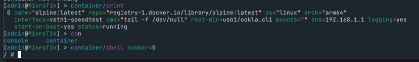

ok its running but cannot shell into it
You need to run
/container/print
to see the correct number of the alpine container. 0 is probably you other container. But it's better that you give it a name, such as alpine and use the syntax from my previous screenshot:
/container/shell [find name="alpine"]
thanks, only had 1 container. but i guess its got weird syntax.

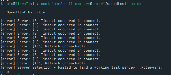

Im going to try wget and tar ookla file
How do I run this on not ROS 7.20rc2 versions. like 7.17.2 or 7.19.4.
I will update on my test mik to 7.20 for this example though.

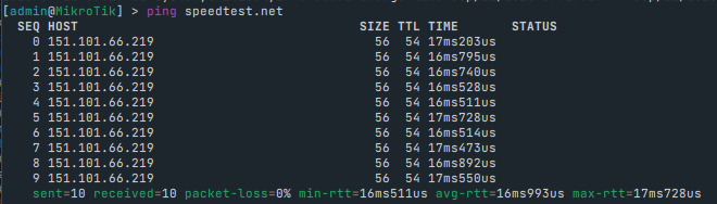

container up and shell works on 7.20. but cannot run test. DNS is set and speedtest.net is reachable.
It's a new feature that you can see in the 7.20 changelog:
  • container - added option to execute commands inside a container using "/container/shell cmd= user=" (additional fixes);
