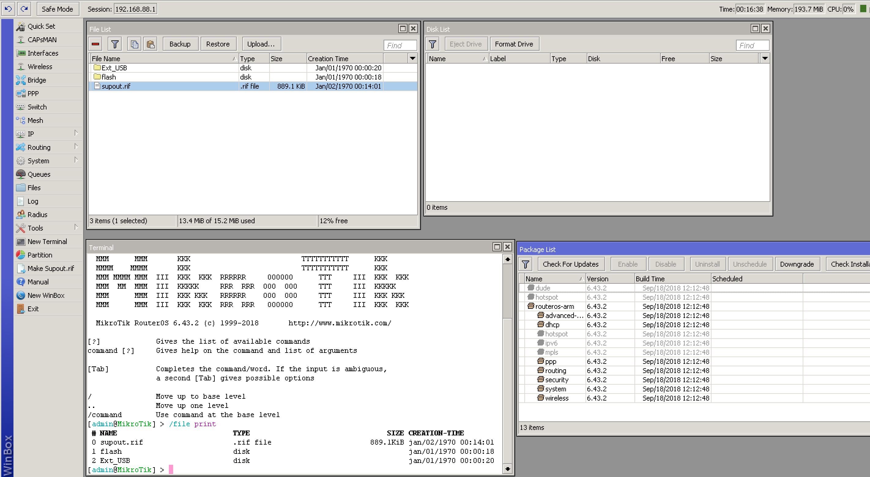

I have continued package upgrade problems with hap ac2 which I believe are memory/flash issues.

Below is screen shot after:
  • full system reset via WINBOX (no backup), no other configuration afterwards, just accepting default.
  • try to delete EXT-USB folder (it goes away and comes back couple of minutes later)
  • ask to uninstall DUDE etc. and do reboot, no success
  • ask device to upgrade to latest version 6.43.4 and reboot, no success.

Looking at OP’s screenshots I’d say that reason for his device not wanting to upgrade is package hotspot which seems to be installed twice - once as part of basic bundle and the other time as extra package. Upgrade procedure seems to not be able to deal with such installations. Way out is indeed netinstall (because it wipes off flash), but then one should be careful not to install same package again.
