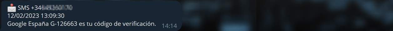

If we test it in Telegram, the result is OK.

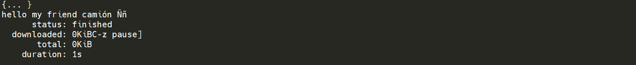

:put [$text]
And on the terminal screen it is also OK.

The string on example is the converted string “hello my friend camión Ññ” to UCS-2
Entry points: ó = 00 FE, Ñ = 00 D1,ñ = 00 F1
Result is the string for telegram:
%68%65%6C%6C%6F%20%6D%79%20%66%72%69%65%6E%64%20%63%61%6D%69%C3%B3%6E%20%C3%91%C3%B1
Can be decoded here:
https://www.urldecoder.org/
That does work…as designed does not cover all of UCS2 obviously.

Okay, well that’s simplier than UCS-2 from SMS via AT. Your the Huawai modem is doing you a favor here - most modems give you an SMS PDU that requires parsing before you even get to the UCS2.
Your “:local content” variable should already have UTF-8 in it (e.g. the XML metadata <?xml version="1.0" encoding="UTF-8"?>). So you just need to use a different @rextended function with the $content (e.g. [$fURLEncode $content]) before passing it along to telegram:
http://forum.mikrotik.com/t/replace-characters-in-string-url-encode/76863/11
To get the raw UTF-8 bytes into the urlencoded string (e.g. UTF-8 that’s % encoded for use in the HTTP query string).
RouterOS only allows you parse the bytes involved in unicode, but it really doesn’t haven’t unicode support for display/input in CLI/winbox/SSH/etc.

C3 21 C3 23???
this is correct urlencoded string…
campa%C3%B1a%20y%20acci%C3%B3n
ñ = \C3\B1 and ó = \C3\B3
C3 21 = ! and C3 23 = #

And now I get what I need:
Result on screen:
:put “$index $read $phoneTG $date2dmy $contentTG”
40000 false %2B34XXXXXXXXX 12/02/2023 13:09:30 Google+Espa%C3%B1a+G-126663+es+tu+c%C3%B3digo+de+verificaci%C3%B3n.
Result in Telegram:
Thank you very, very much for your patience.
BR.
