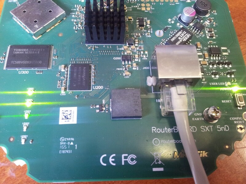

Hello! First of all, sorry for my english. I have a problem with MikroTik SXT Lite5 (RB SXT5nDr2), it just a stopped working - no connection to LAN/WLAN, no beeps, no flashes, anything but power LED and three “signal” LED’s. It has no reaction to “RESET” button, NETINSTALL mode doesn’t work at all, device completely dead. I replaced the CPU with help of BGA rework station and nothing changes, but after i reflash the 25-series FLASH chip with firmware from another mikrotik device (same model), it works! All functioning fine, but my license key was broken. Ill decided to try “repair” bricked firmware with help of working flash image, and eventually license key not work. Winbox tell’s me “Your router does not have any valid key”. Any chances to recover my device’s firmware? I attached my broken rom, modded rom and working rom from another device. Please, help me!

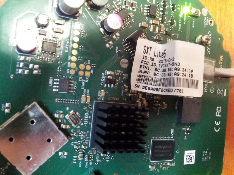

As i said before, “USER LED” no lit, no flash, anything. Serial console method i’m not tried, but i think it doesn’t work, because i’m not seen any signal pulses on “E-JTAG” and “UART” testpoints. Maybe i need initiate the connection? If anyone knows, tell me please how it should work, then i solder cable.

On SXT devices, license stored in both nand and 25-flash chip, on boards with only one flash memory chip, license stored in flash and OTP-area of that flash chip. Any modifications of code will cause a license failure. License isn’t CPU specific, i’ve replaced over few hundreds SoC (AR724*, AR9344-*) without any hardware or firmware modifications and all works fine. So, most simplier way to repair sofware problems is cloning both chips, but in result you’ll been have absolutely identical devices (MAC’s and serials). Another way to repair - edit 25-flash dump. In most cases problem hide in ~ first kilobyte of data, you’ll need to know what version of routerboot on your dead device and insert the piece of code from the same version of working dump. After that, in most cases device will react on reset button and you can reflash it in a normal way via netinstall. So sad that mikrotik support is oriented for sales, not for support at what it must be. All of my support tickets ended the same way - RMA or buy the new one.
