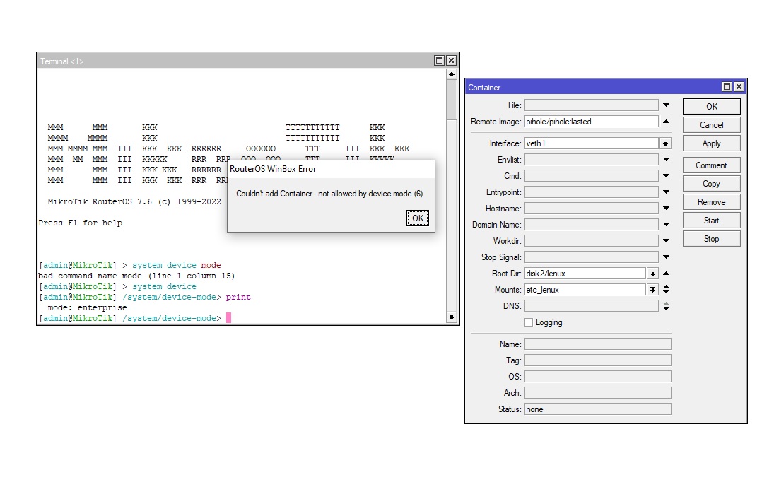

couldn't add container not allowed by device-mode
device mode is updated and turning off and on again but ros say : couldn’t add container not allowed by device-mode
my routeros is chr 7.5
how to sloved problem ?
Dear mikrotik developers, please add the ability to change device-mode easier especially for chr
The awkwardness of changing device mode is such on purpose … to make remote attacker life more difficult. Having said that, indeed cutting power to device doesn’t work as advertised, one really has to press the mode button to make the change permanent. In CHR cutting power is probably same as hard resetting VM from VM hypervisor management interface a d I no idea what’s mode button alternative.
Off-topic: I fail to see the need to run containers inside CHR, a much better infrastructure is already in place when running CHR and I’d definitely go for a proper container platform (docker inside linux, running on the same VM infrastructure as CHR, is one, pretty simple, possibility).
