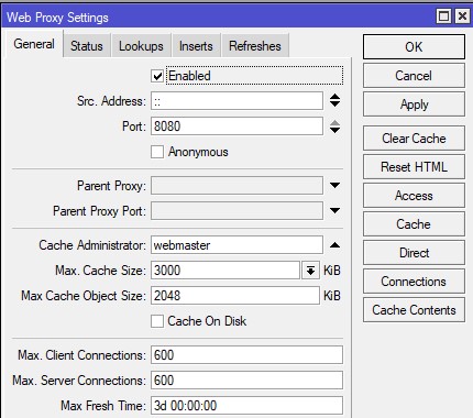

  • You could set up the web-proxy in the Mikrotik, and define the Mikrotik 192.168.1.1 as proxy server in your PC browser

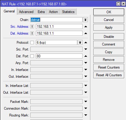

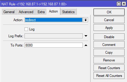

  • After setting up the web-proxy. You could redirect HTTP traffic to the web-proxy port 8080 in the Mikrotik NAT rules. (avoiding the need to define the web proxy in the PC browser)

Illustration of the web-proxy + redirect, so you can browse to the device directly connected to the Mikrotik. (I changed my subnet 87 to yours)
