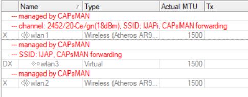

I have configured CAPsMAN on my friends HapAClite and experienced quite strange behavior at least for me, because it have never occurred to me before.

The 2.4 GHz was always configured correctly and I could use it right after the router booted up.
But the 5 GHz interface was up just occasionally.
