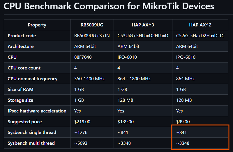

I used a container with sysbench:
  • --test=cpu --threads=1
  • --test=cpu --threads=4
/container/add remote-image=mirror.gcr.io/zyclonite/sysbench cmd="--test=cpu --threads=1 run" interface=veth1 logging=yes name=sysbench root-dir=docker/sysbench
RB5009 - CPU 88F7040
threads: 1
CPU speed: 1276 events per second
threads: 4
sysbench: CPU speed: 5093.27 events per second
HAP AX3 - CPU IPQ-6010
threads: 1
sysbench: CPU speed: 841 events per second
threads: 4
sysbench: CPU speed: 3347.89 events per second
HAP AX2 - CPU IPQ-6010
threads: 1
sysbench: CPU speed 401.24 events per second
threads: 4
sysbench: CPU speed 1602.72 events per second
Conclusions
RB5009 (88F7040)
The leading device with performance 52% higher than the HAP AX3, but also 58% more expensive.
HAP AX3 (IPQ-6010)
Decent results with a good price-to-performance ratio.
HAP AX2 (IPQ-6010)
It has the same CPU but absolutely not the same performance as the ax³ IPQ-6010. Due to the smaller form factor the ax² is worse at dissipating heat, so the CPU clock is limited to the base frequency, while the ax³ can boost to 1800MHz. It shows about 48% of the HAP AX3 performance in single-threaded mode and about 48% in multi-threaded mode. Despite this, thanks to its low price ($99), it offers an acceptable price-to-performance ratio for basic tasks. However, the lack of a USB port makes it less attractive and there is no particular point in buying this device for running containers.

Thanks for the results, updated the information
The first table on your GitHub page still needs an update:
Thanks I fixed it
