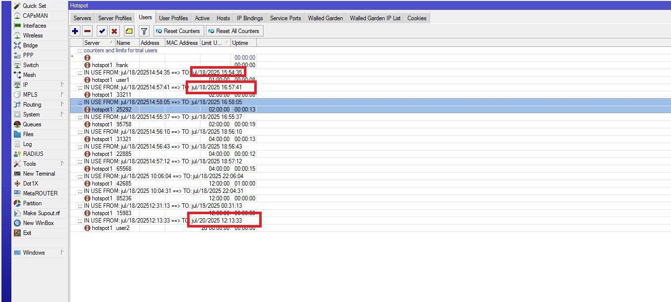

I’m new to MikroTik scripts and have received a lot of help with the scripts you guys have created. I want to create a script to delete a user in a hotspot when that user has used up their usage time. The user’s expiration time would be written in the comment.
Thank you for your valuable collaboration.
With the help of the forum, I was able to create this script, and it works perfectly. Now I need to create a script that deletes online users when their date and time expire. Can anyone give me a clue on how to solve this? Thanks.

Thanks for your help Amm0. The version is 6 and this is the script:
:local dateint do={
:local montharray ( "jan","feb","mar","apr","may","jun","jul","aug","sep","oct","nov","dec" )
:local days       [:pick $d 4  6]
:local month      [:pick $d 0  3]
:local year       [:pick $d 7 11]
:local monthint   ([:find $montharray $month])
:local month      ($monthint + 1)
:if ( [len $month] = 1) do={
:local zero ("0")
:return [:tonum ("$year$zero$month$days")]} else={:return [:tonum ("$year$month$days")]
:local timeint do={
:local hour       [:pick $t 0 2]
:local minutes    [:pick $t 3 5]
:return ($hour * 60 + $minutes)}
:local mydate     [/system clock get date]
:local mytime     [/system clock get time]
:local today      [$dateint d=$mydate]
:local curtime    [$timeint t=$mytime]
:foreach i in     [ /ip hotspot user find where ] do={
:local mycomment  [/ip hotspot user get $i comment]
:local myname     [/ip hotspot user get $i name]
:local getdate    [:pick $mycomment 52 63]
:local gettime    [:pick $mycomment 64 72]
:if ([:pick $mycomment 55] = "/" and [:pick $mycomment 58] = "/") do={
:local expd       [$dateint d=$getdate]
:local expt       [$timeint t=$gettime]
:if (($expd < $today and $expt < $curtime) or ($expd < $today and $expt > $curtime) or ($expd = $today and $expt < $curtime)) do={
 [/ip hotspot user remove $i]
 [/ip hotspot cookie remove [find where user=$myname]]
 [/ip hotspot active remove [find where user=$myname]]
Because as you can see in the graphic the date is all in “lowercase”, that’s why I use it.
I hope you understand me and can correct my script, if it needs correcting. Thank you.
