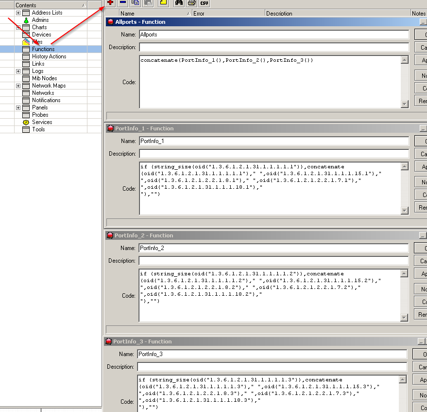

If you realy need it, you can do it. In my sample I have 4 functions for 3 interfaces, you will need 25 or 49 function, may be more, depending on interface count on your switch. :slight_smile:
Note: there is no for or foreach statement in a dude functions.
<?xml version="1.0" ?>
<dude version="4.0beta2">
 <Function>
  <sys-type>57</sys-type>
  <sys-id>11355794</sys-id>
  <sys-name>PortInfo_3</sys-name>
  <code>if (string_size(oid("1.3.6.1.2.1.31.1.1.1.1.3")),concatenate (oid("1.3.6.1.2.1.31.1.1.1.1.3")," ",oid("1.3.6.1.2.1.31.1.1.1.15.3")," ",oid("1.3.6.1.2.1.2.2.1.8.3")," ",oid("1.3.6.1.2.1.2.2.1.7.3")," ",oid("1.3.6.1.2.1.31.1.1.1.18.3"),"\0d\0a"),"")\0d\0a</code>
 </Function>
 <Function>
  <sys-id>11355285</sys-id>
  <sys-name>PortInfo_2</sys-name>
  <code>if (string_size(oid("1.3.6.1.2.1.31.1.1.1.1.2")),concatenate (oid("1.3.6.1.2.1.31.1.1.1.1.2")," ",oid("1.3.6.1.2.1.31.1.1.1.15.2")," ",oid("1.3.6.1.2.1.2.2.1.8.2")," ",oid("1.3.6.1.2.1.2.2.1.7.2")," ",oid("1.3.6.1.2.1.31.1.1.1.18.2"),"\0d\0a"),"")\0d\0a</code>
 </Function>
 <Function>
  <sys-id>11355275</sys-id>
  <sys-name>PortInfo_1</sys-name>
  <code>if (string_size(oid("1.3.6.1.2.1.31.1.1.1.1.1")),concatenate (oid("1.3.6.1.2.1.31.1.1.1.1.1")," ",oid("1.3.6.1.2.1.31.1.1.1.15.1")," ",oid("1.3.6.1.2.1.2.2.1.8.1")," ",oid("1.3.6.1.2.1.2.2.1.7.1")," ",oid("1.3.6.1.2.1.31.1.1.1.18.1"),"\0d\0a"),"")\0d\0a</code>
 </Function>
 <Function>
  <sys-id>11355290</sys-id>
  <sys-name>Allports</sys-name>
  <code>concatenate(PortInfo_1(),PortInfo_2(),PortInfo_3())</code>
 </Function>
</dude>

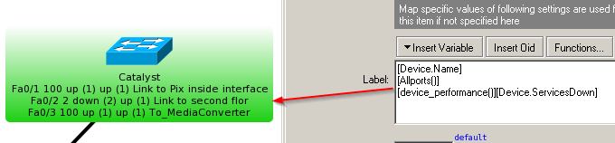

This is similar to my second attempt but with 48 port switches it just doesnโ€™t work on the map. That is why I was hoping to have the information come up in a table similar to the snmp tab for a device. I had the information come up in the tool tip and it worked but for the fact that all non switch equipment would have 48 blank lines in the tool tip. Otherwise you have to manually edit the tool tip for every single switch.
