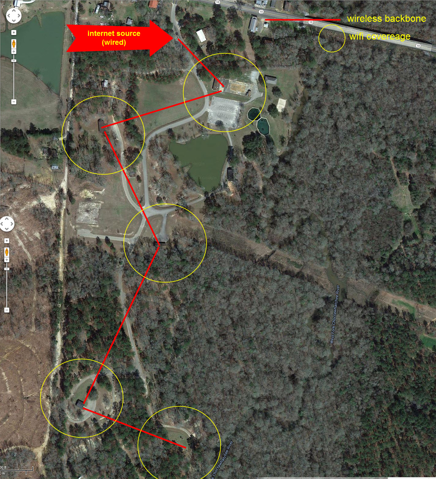

I’ve included an image of the desired coverage area. I don’t have a preference if this is done daisy chain or start topology. I am looking for best effectiveness with minimal cost. Now that being said, I will pay for quality, I just don’t want to drop $10,000 on parts when I can do the same thing with $2,000. The distance from tip to tip is a mile maybe.
You’d better use star topology.
I’d deploy a 5Ghz sector on Internet Source, suitable candidates:
Then on each distribution point an SXT Lite5 ac would be connecting to the sector, and another, seperate suitable radio would provide local wireless 2,4GHz coverage, or dual 2.4 and 5GHz coverage depending on the needs: could be a single 951, a wAP AC, a Pair of them, a single 912 (2.4GHz version) to cover a big outdoors area, it depends.
The benefit is backbone network and coverage networks are seperated in terms of hardware, to have the utmost flexibility.
