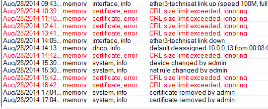

Could anybody explain what this means exactly and what are the CRL requirements in terms of limit/length? RB751G, ROS 6.19

Add to this older/existing thread. I’ve purchased an SSL certificate from PositiveSSL/Comodo and installed in on my RB750Gv1 and v2 (hEX) routers. The certificate package includes 4 files. Every hour I get the same error log message: CRL size limit exceeded, ignoring. I’ve used both v6.19 and v6.32.4 firmwares. Note that the log error message does not indicate which of the four certs is causing the error. Can I get an explanation and hopefully a fix from Mikrotik please?

Question to the forum/Mikrotik - exactly what happens when you get this Log error of CRL ignored? Does it not apply/use it or is it more of a warning but still is used? Thanks.
It means that router doe snot have enough RAM to download CRL file at a time. If CRL is not downloaded certificates cannot be verified.
