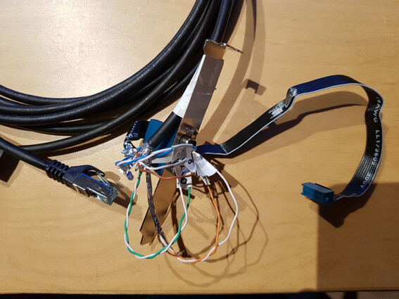

Hi biomesh,
just wanted to show that I have instantly build a serial cable mac gyver style :wink:
And you will not believe it: it worked!
I could connect to console and set boot os back to routeros.
Now everything works fine! :slight_smile:
Thank you very much!
