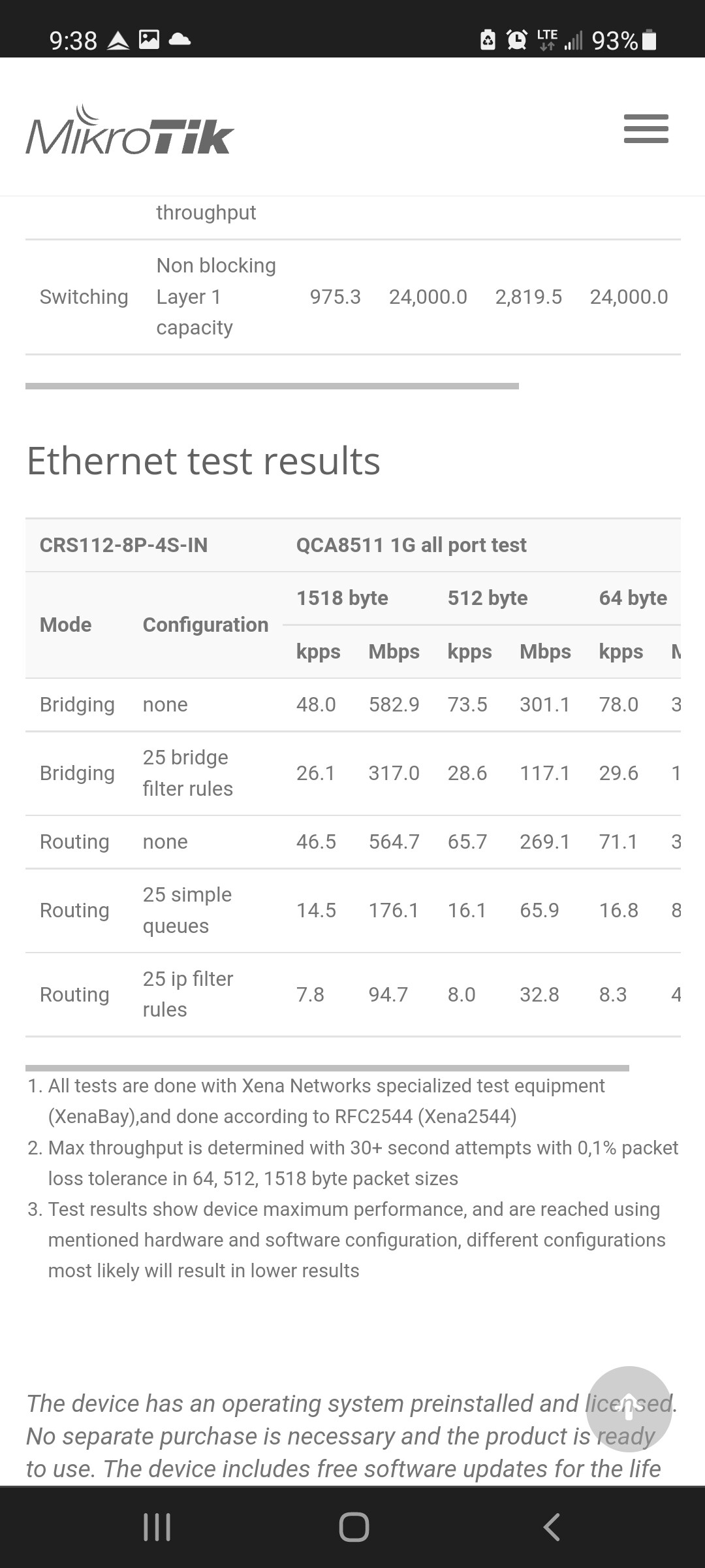

CRS112 is more oriented as a switch rather than a router, but 12mb is too much try to change the cable first but don’t expect too much
https://mikrotik.com/product/crs112_8p_4s_in#fndtn-testresults look for 512 byte with 25 ip filter rules
What is the configuration of the CRS112 ?
Is it configured as a switch connected to a router ?
Or is it configured as a router ?
If the second, then as stated on the previous post, CRS112 is a switch it has an advanced switch chip but limited CPU performance…
