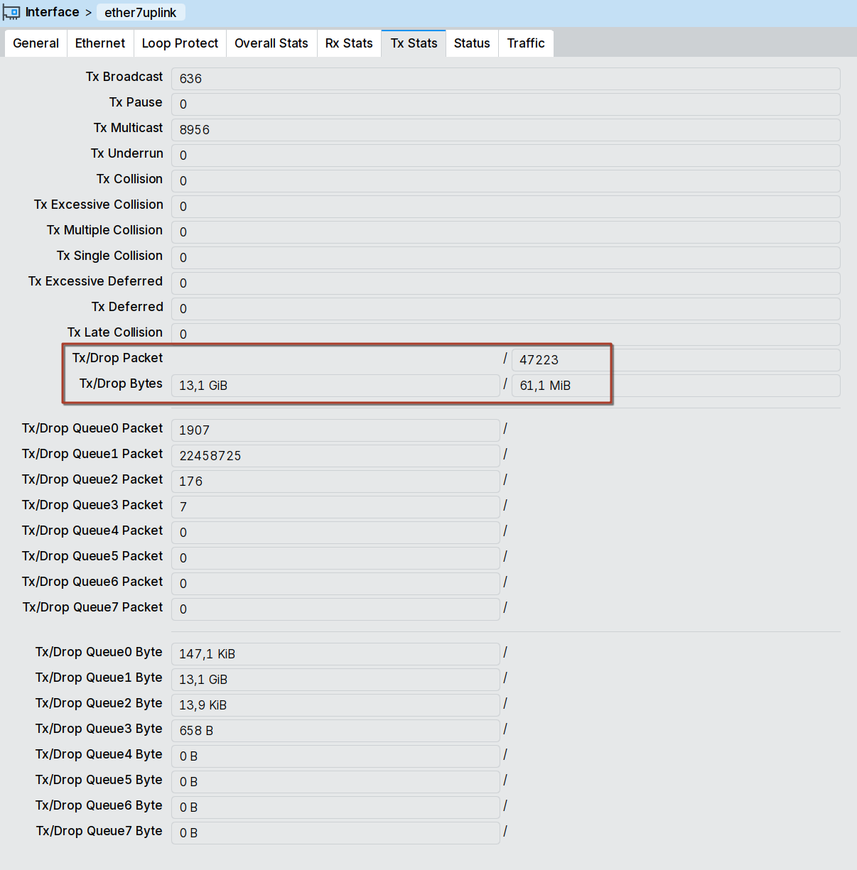

CRS112 uplink high tx-drop-packet and tx-drop-byte
  • hardware: CRS112-8G-4S
  • RouterOS: 7.22
The switch is really just switching and the CPU load is low. There are six servers behind it (black boxes for me), and ISP uplink connected. All 1Gbps Ethernet.
I am seeing a very high number of tx-drop-packet and tx-drop-byte on my uplink interface. No other kinds of errors.
I am trying to understand what’s happening, but can’t actually find any clear definition of tx-drop-packet and tx-drop-byte in the docs. I suppose that the relevant line in the ROS → Wired connections → Ethernet docs is:
tx-drop (integer) Total count of transmitted frames that were dropped due to the already full output queue
Is this correct? It seems to me this contains the drops across all the queues. There are Tx counters per queues, but the drop counters per queue are missing.

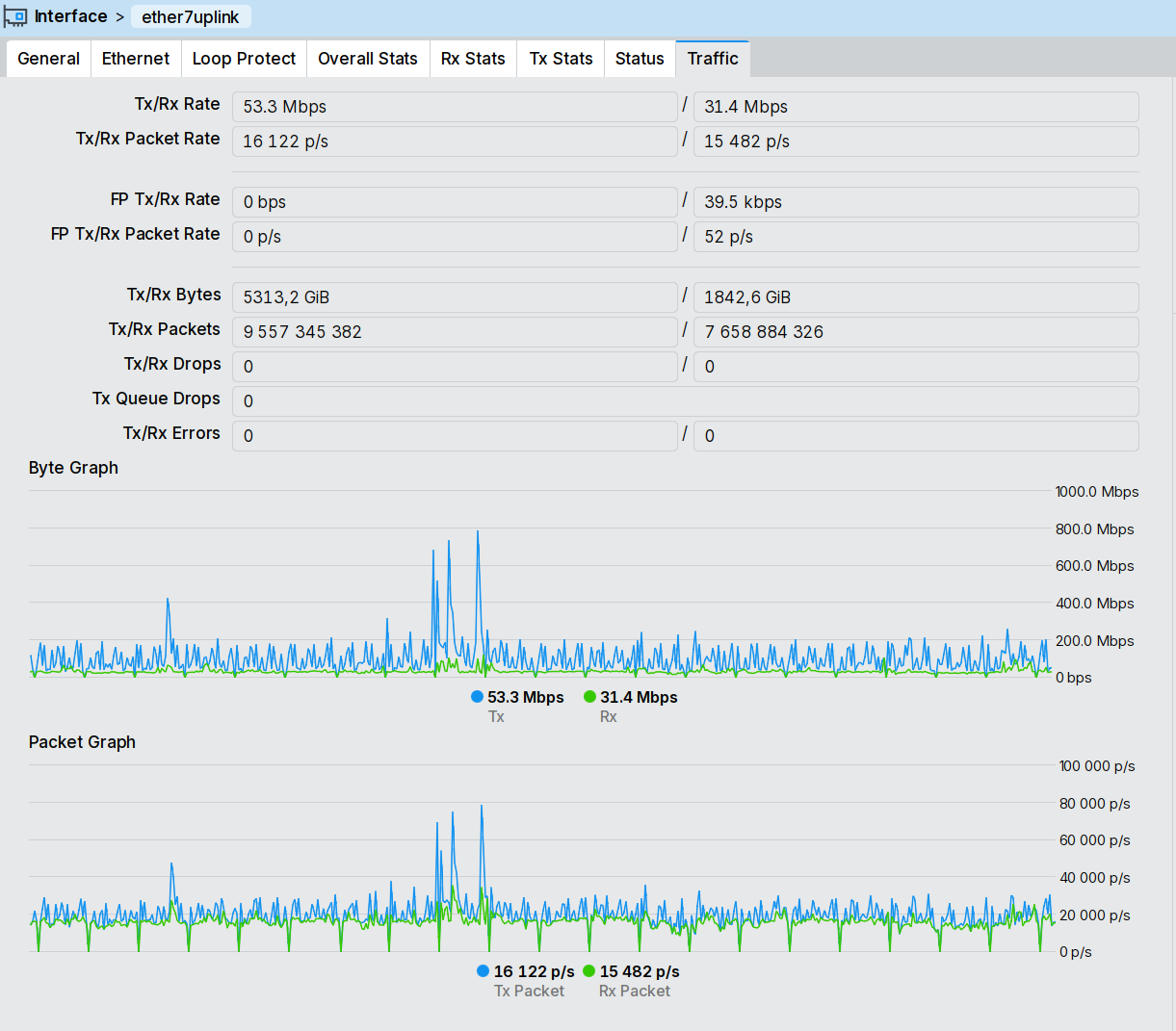

Interestingly, when I run /interface monitor-traffic ether7uplink, the tx-queue-drops-per-secondnever shows anything but 0, and the tx-bits-per-second is in higher tens or lower hundreds (mostly 50 - 200 mbps, although now I see a few bursts to about 800 mbps when I look at the WinBox graph). The tx-drop-* grows even in these 30-200 Mbps periods, outside of the visible 800Mbps spikes.
What I would like to understand is:
  1. Is this due to bursts leading to queue buffer overflow that are not visible on the graph?
  2. If so, why on the Traffic tab, why Tx/Rx Drops and Tx Queue Drops are 0?
  3. Is this hitting packet per second or bits per second ceiling?
  4. Can something be done about this problem? ISP say they don’t see any errors and don’t do any traffic shaping on this port.
    1. I briefly switched the port from only-hardware-queue to multi-queue-ethernet (mq pfifo, queue size 50 - the default), seemed make no difference.
Looking forward to learning more about this!:slight_smile:
This is a few minutes after resetting the counters:

You could maybe try multi-queue-ethernet-default as per the following topic.
Thanks for the reply @rplant!
I saw exactly this topic and already tried that - the counter continued to grow (I didn't, however, notice/graph if it grew more slowly or not).
You could try enabling tx flow control and rx flow control on all interfaces,
and see if that helps. (And doesn't break other things.)
I have exacly the same issue Mikrotik CRS318-16P-2S+OUT - with 7.16 and 7.19 this issue does not exist. If we upgrade a old Version to the new 7.22 the issue starts.
We find out that this issue currupt IPSec Tunnels and traffic in this Tunnels. For example in some situation RDP Connections drop in the tunnel, while ping traffic works without issues or Voip calls drops.
vxlans over this interfaces has issues too. To play with other queue types or sizes doesnt change anything.
Enable/Disable Flow Control does not have a effect of this issue.
