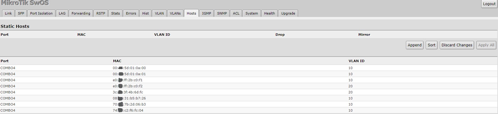

In the hosts tab, I am able to see the DHCP servers MAC adresses, and they are discovered on the correct VLANs aswell.

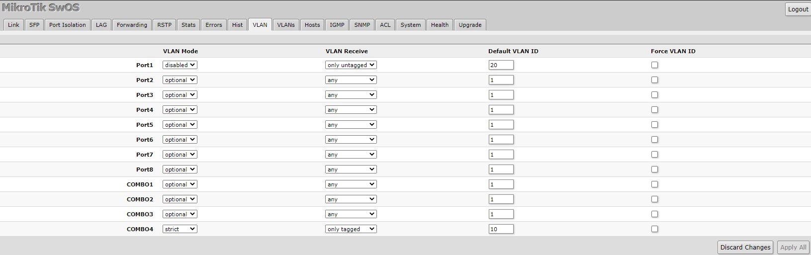

I’ve attached the config file (changed to txt), as well as screenshots of the following tabs: VLAN, VLANs, Hosts.

Based on the hosts tab, you only have one connection to the switch - port 12. What are you trying to accomplish?

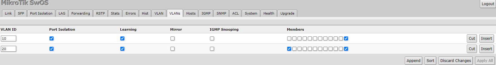

You don’t have VLAN 1 assigned to any ports on the VLANs tab. BTW, I generally recommend against using VLAN 1 unless you really have to. Here are a couple screen captures of on of my switches. That may give you some hints.

Port 12 is my uplink a different switch, which sends the VLANS through a trunk. Blackhole vlan is untagged, and vlan 10, 20 is tagged. However, just untagging a single vlan, does not give me a different result as the client on my Mikrotik Switch. The hosts is just most of other devices on my network, in their respective VLANs, COMBO4 #3 and #4 (from top), is my Firewall/DHCP Server, on both VLAN 10 & 20.

I then see you do not have Port Isolation. I’m not sure whether to keep this enabled, or disable this, but in Mikrotiks own Wiki, they don’t change this, and seems to get it to work.

On your port 1, on the VLAN tab, change VLAN mode to disabled and VLAN Receive to Only untagged. Off hand, I suspect that the switch is trying to send VLAN tagged traffic to your client PC - which likely will not work.
Yes, On my config, any port that will have a non-VLAN aware device (most end devices) have VLAN mode disabled, and VLAN receive set to Untagged only. The default VLAN for that port is set to the desired VLAN and on the VLANs tab, only that one VLAN is set on that port. On trunk ports (1, 24, 25, & 26), the VLAN mode is set to strict, the VLAN receive is tagged only and the default VLAN is a dummy number. On the VLANs tab, all the desired VLANs are enabled on the trunk ports. The only odd-balls are the ports (23 & 21) set up for my managed WiFi which uses a untagged LAN for management and VLAN tagged LANs for each SSID. Those are set to VLAN mode of strict, VLAN receive mode to any, and the default VLAN to whatever VLAN will be used for untagged management. On the VLANs all five VLANs (one management and four SSIDs) are allowed on the port.

But from what you mentioned, vlan mode should be disabled to clients? (Now when I think over it, it makes more sense than enabled, or other).

So I’ve disabled port isolation, and changed my VLAN config, as you can see in the attachment.
Still no luck..

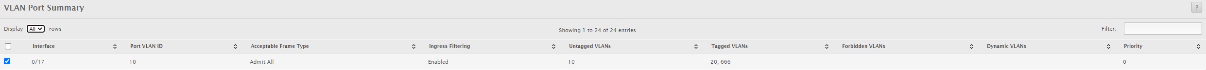

I’ve taken a look through my EdgeSwitch.

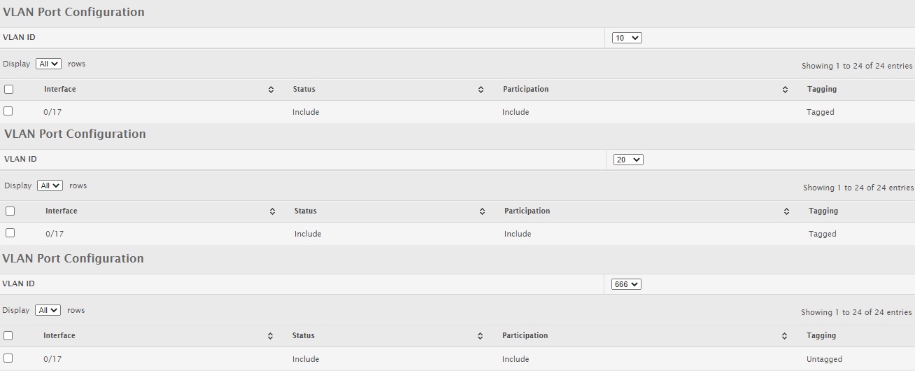

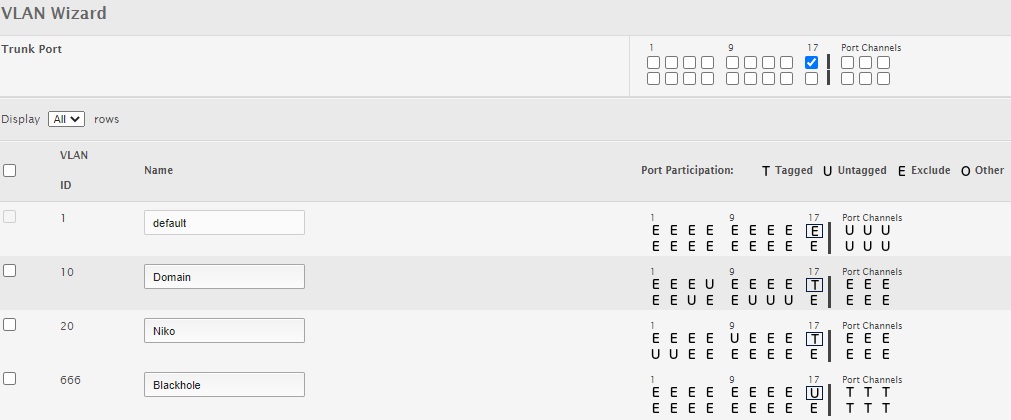

See the attached images from my EdgeSwitch. Neatly edited to only show the requested port / vlans.
The Vlan Port Configuration, shows all 3 VLANs, 10, 20, 666, here 10 and 20 is tagged, with 666 untagged.
The VLAN configuration, shows my trunk, set up with vlan 10, 20, 666, with 10, 20 tagged, 666 untagged.

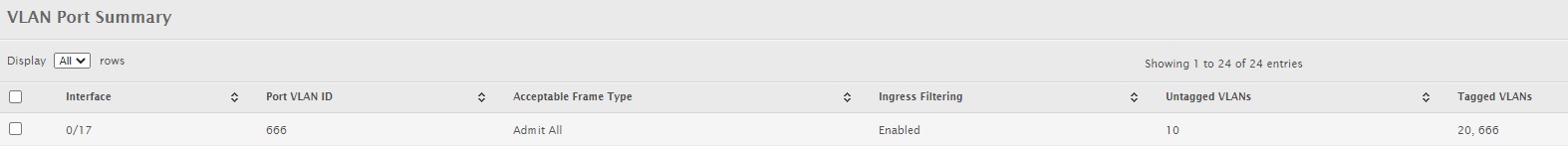

Now.. The Port Summary, should display the same as the other tabs?? Apparently not. This displays untagged vlan 10, and tagged vlan 20, 666. (Keep in mind changing the Port VLAN ID, did not change any results of the tagged/untagged vlans).
This shouldn’t differ from the other configurations?
Hope this is what you’ve asked for (not sending config because of UNMS, etc.)
The last image in your post with the VLAN Port Summary is showing vlan 10 as untagged. Can you test setting the Port VLAN ID to 666? I am thinking that the vlan 10 being defined as the Port VLAN ID is causing the frames to come across untagged and on the Mikrotik side, you need them to be tagged.
Thanks again.
Very quick answer, it does not change the tagged/untagged VLANs. Neither does changing default vlan on the Mikrotik switch.
See the attachment.

I still think there is an issue with your edge switch and the fact that vlan 10 is still showing as untagged and 20 and 666 are showing as tagged even though you specifically called out 10 to the tagged and 666 to be untagged.
This is why vlan 20 works but 10 doesn’t.

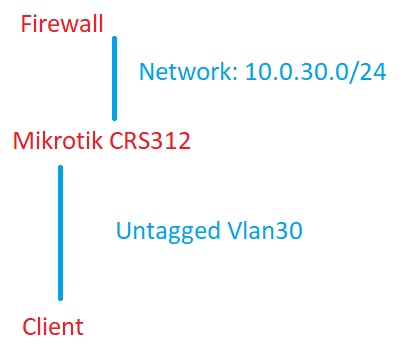

I’ve made a small picture in paint, showing the most simple Vlan setup doesn’t work.
Network send to the Mikrotik Switch, is directly from my Firewall.
Here I untag the network to Vlan30, and untag Vlan 30 to the client port.
My Client cannot receive a DHCP address (gives itself an APIPA), and I cannot communicate out from the Switch, with a static IP.
If I select my Switch to obtain it’s IP through DHCP, it will get an IP, which means the connection to the Switch works, but it seems it cannot direct it to my clients.
Changing around with VLAN mode and VLAN Receive, does nothing, and at all times the VLAN member ports are selected (port isolation disabled).
It’s unfortunate, but if it’s faulty I’ll have it replaced, if not it will probably be returned.
