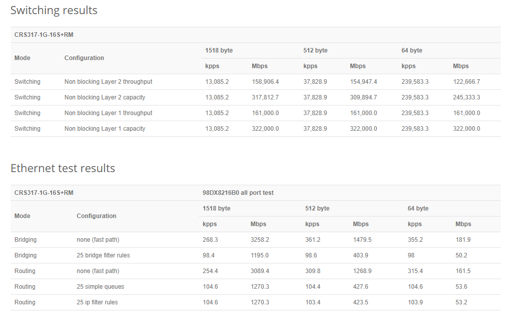

Nope I mean L2, this has one router in it's table and it's only for the management vlan which itself has an IP on. it's doing only layer 2 switching and according to the product it should be dishing out 10gb link speeds no issue:
Which leads me to making this and asking if this can only reach "switching" speeds using SwitchOS or can I achieve this without having to use SwitchOS. Lot of confusion for this product on the docs.
