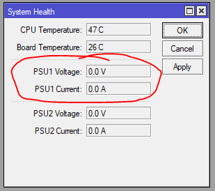

Thanks for the response, I have completed the full reset and still the same. One further investigation when i go into health check the PSU voltage and amperage is showing as 0.0. Surely this should be showing 240v and some amount of amps?
No, it should show PSU output, so about 24V for first PSU, about 48V for second PSU.
