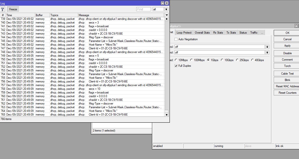

Hello, blackangel1
Try apply following configuration to port where the UF-RJ45-1G module is plugged - disabled auto-negotiation, forced speed to 1G, and enabled full-duplex. Module re-plug may be needed.
as you can see on attached picture
disabling negotation only shows link ok
but i am not getting IP from DHCP
